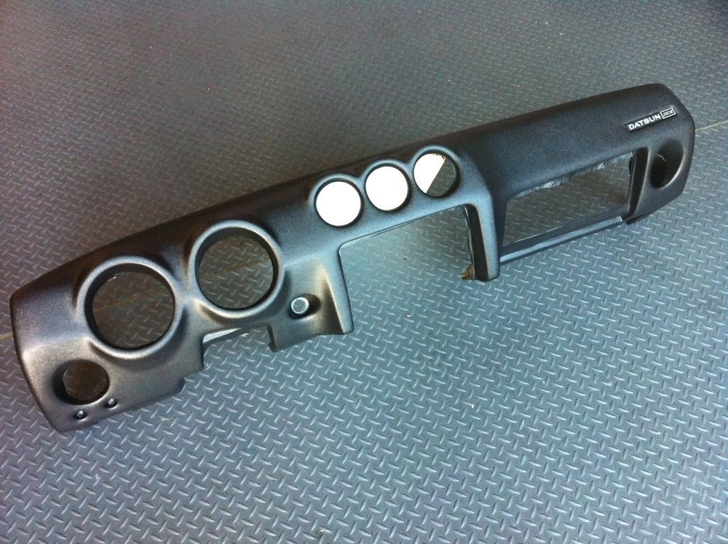

I upholstered my seats, door panels, and transmission tunnel using pre-cut, stitched leather kits from a couple of sources. The dash ended in disaster. The kit for the dash was ordered from a company in the UK and did not fit right. I shipped it back and they replaced it with a better but still not correct fit. I replaced a few panels on the dash cover they sent but it was still not correct. After a few month, it shrunk and I'm ready to strip it off. I've done some minor leather sewing (i.e. I'm a novice) and was going to try and start from scratch with leather or a leather alternative.

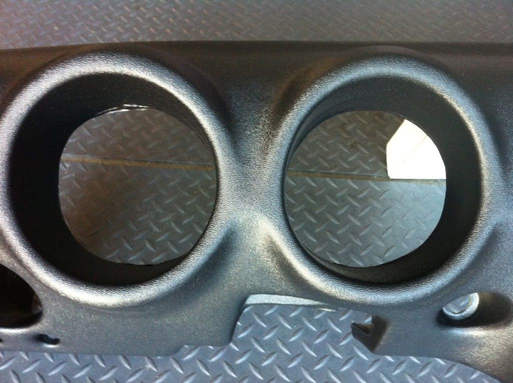

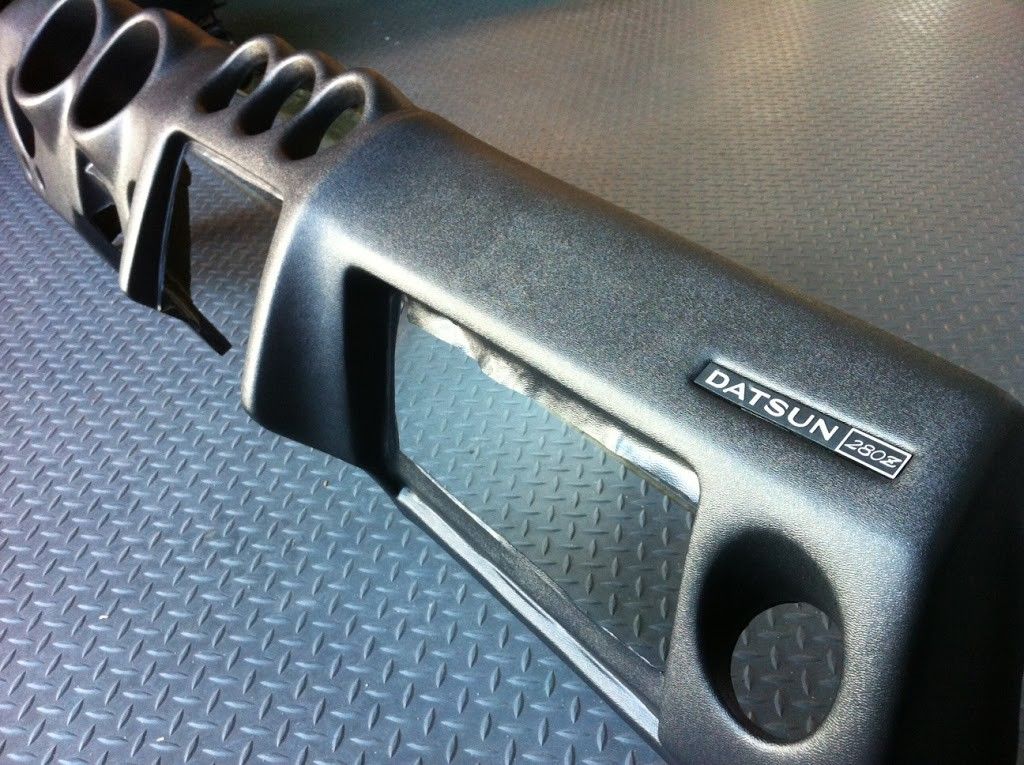

I read in a post here that Allsport might be a good leather alternative because its stretchy and durable. Are there any training videos on using this material? Because of the many curves in this dashboard, I'm going to need to do a lot of contouring. The inset gauges were a pain in the butt when I used the precut leather cover. I've attached photos showing a similar dash so you can see what I'm dealing with.
