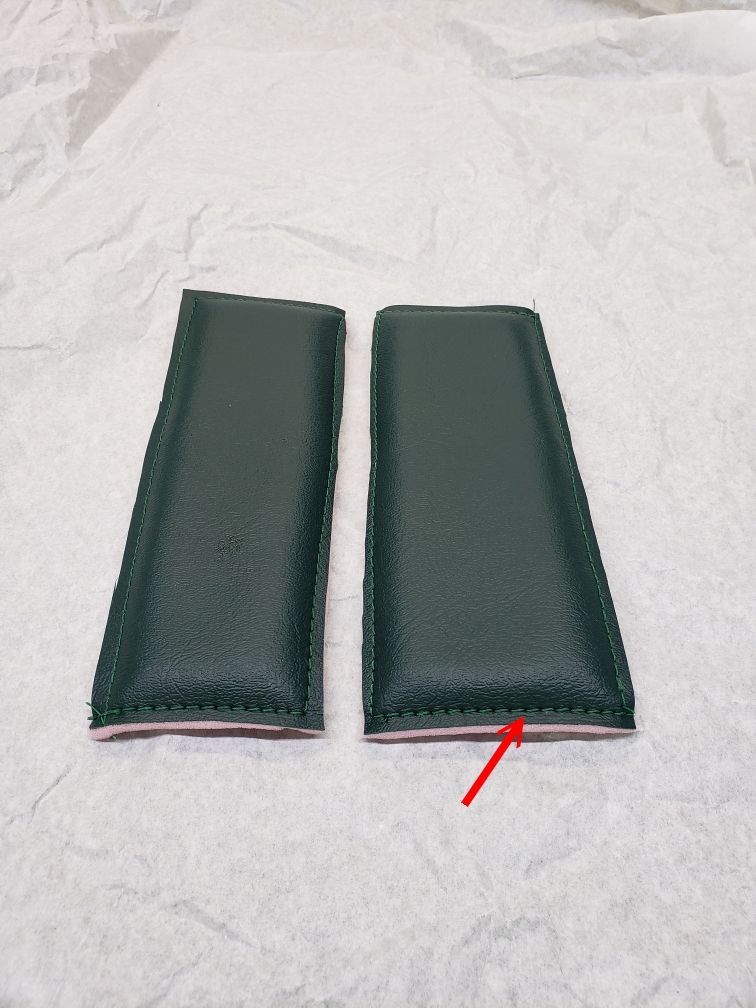

Here are some pics of the way I have been doing my top stitching.
Step 1 (Pic 1) Edge stitch around the perimeter (1/2” sew foam).
Step 2 Join the panels with a ½” seam allowance.
Step 3 Panels top stitched. (Top stitch is a bit too close to edge).

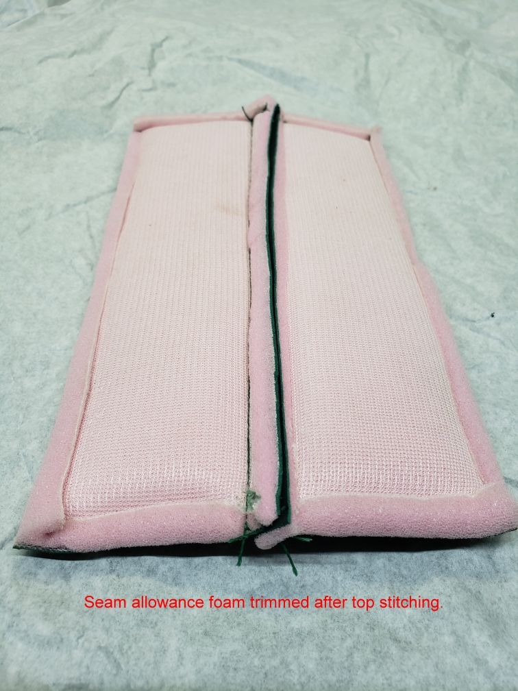

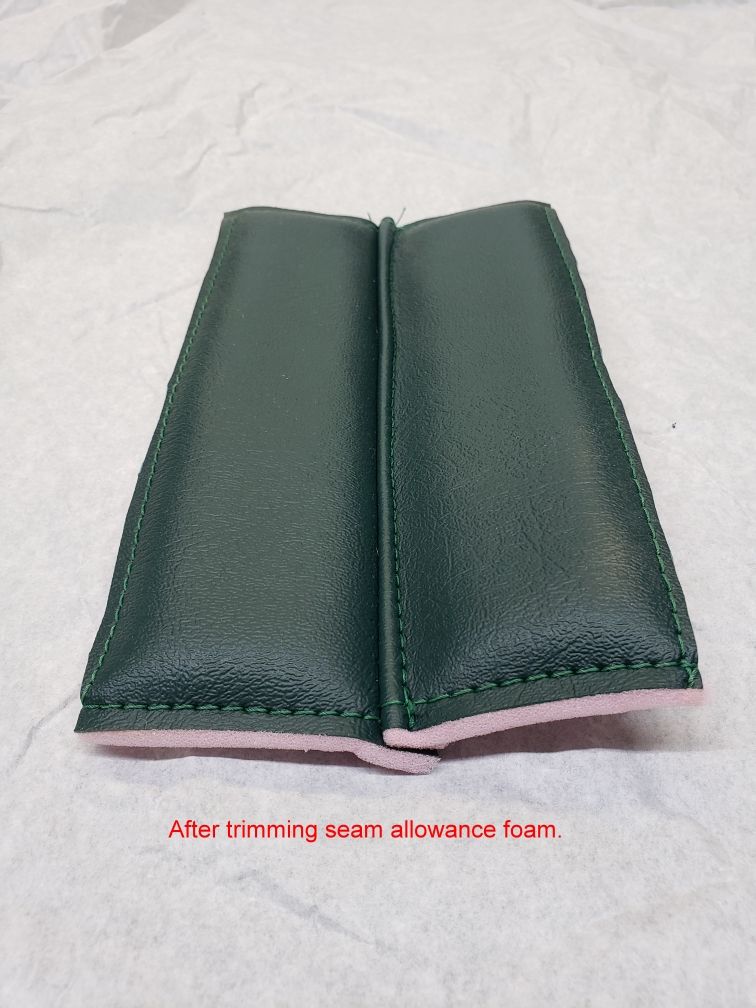

Step 4 (Pic 2 & 3 ) Seam allowance foam trimmed back. The edge stitches from step 1 prevented closer trimming.
From what you have said, I think my problem is sewing around the perimeter on the seam allowance where the top stitch will go. I think at least one of the edges on the two seam allowances should not be edge stitched, making it possible to strip back more of the foam before top stitching.
Any additional thoughts would be appreciated.
Panels with perimeter stitching.
Panel 1.jpg (100.58 KiB) Viewed 6402 times
Top stitched - seam allowance foam trimmed
Panel 6.jpg (99.96 KiB) Viewed 6402 times
Panel 4.jpg (118.99 KiB) Viewed 6402 times

Good question! After you sew your basic seam you have to trim off the foam in the seam allowance as close as you can to the stitch.
When ever I know I will be doing french seams on a cover I try to avoid using 1/2" in those areas but its not always possible

I may be doing a wrong thing, but, when I have 1/2" foam and I want smooth clean transitions, I will cut the foam short for the seam allowance. Meaning, that if I have a 1/2" seam allowance there is no foam on the seam allowance. This way I can lay the fabric back and there is no bulk material. And Yes, it is difficult to do on some panels. Well, for me anyway.
