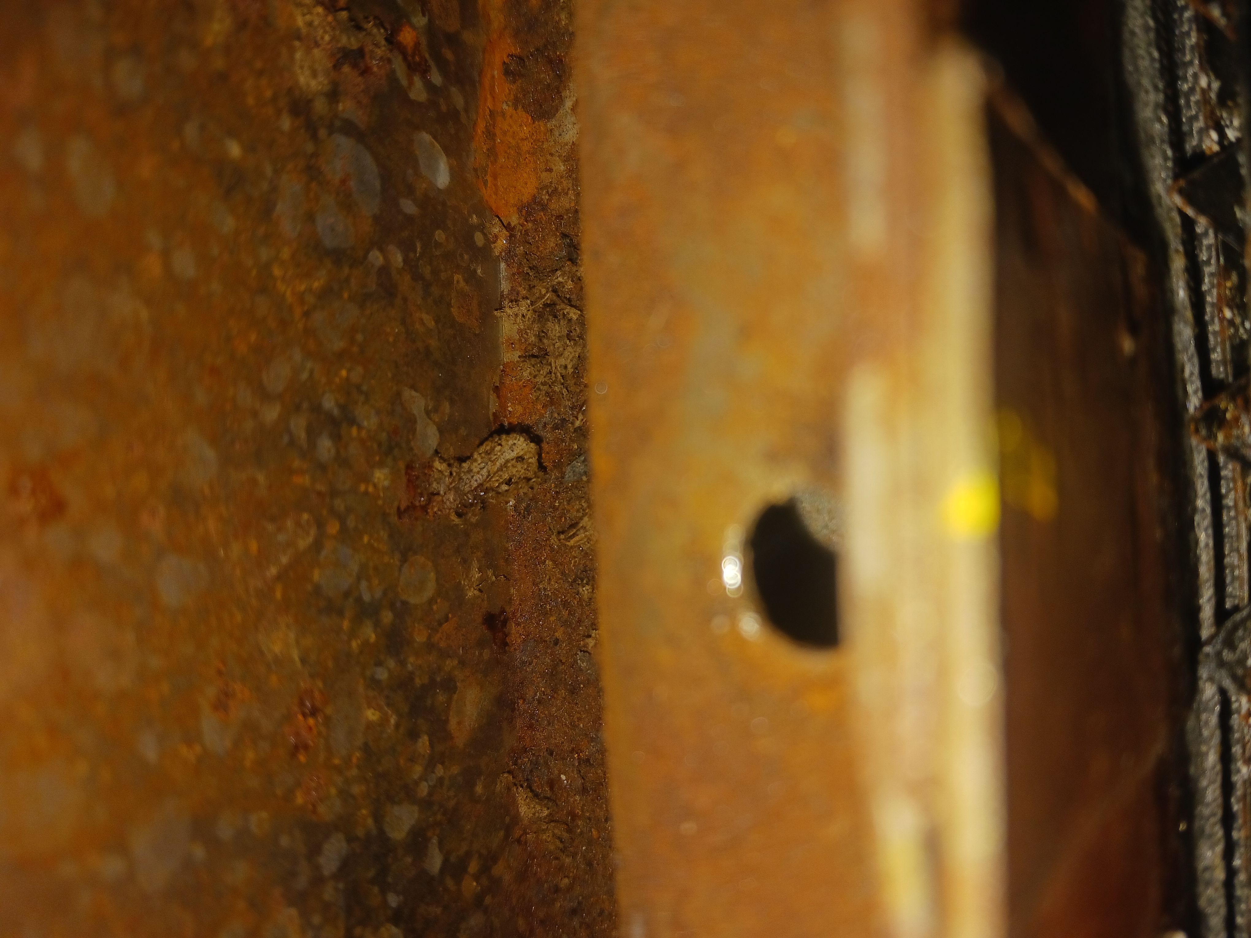

Yellow marks bow hole above lr door

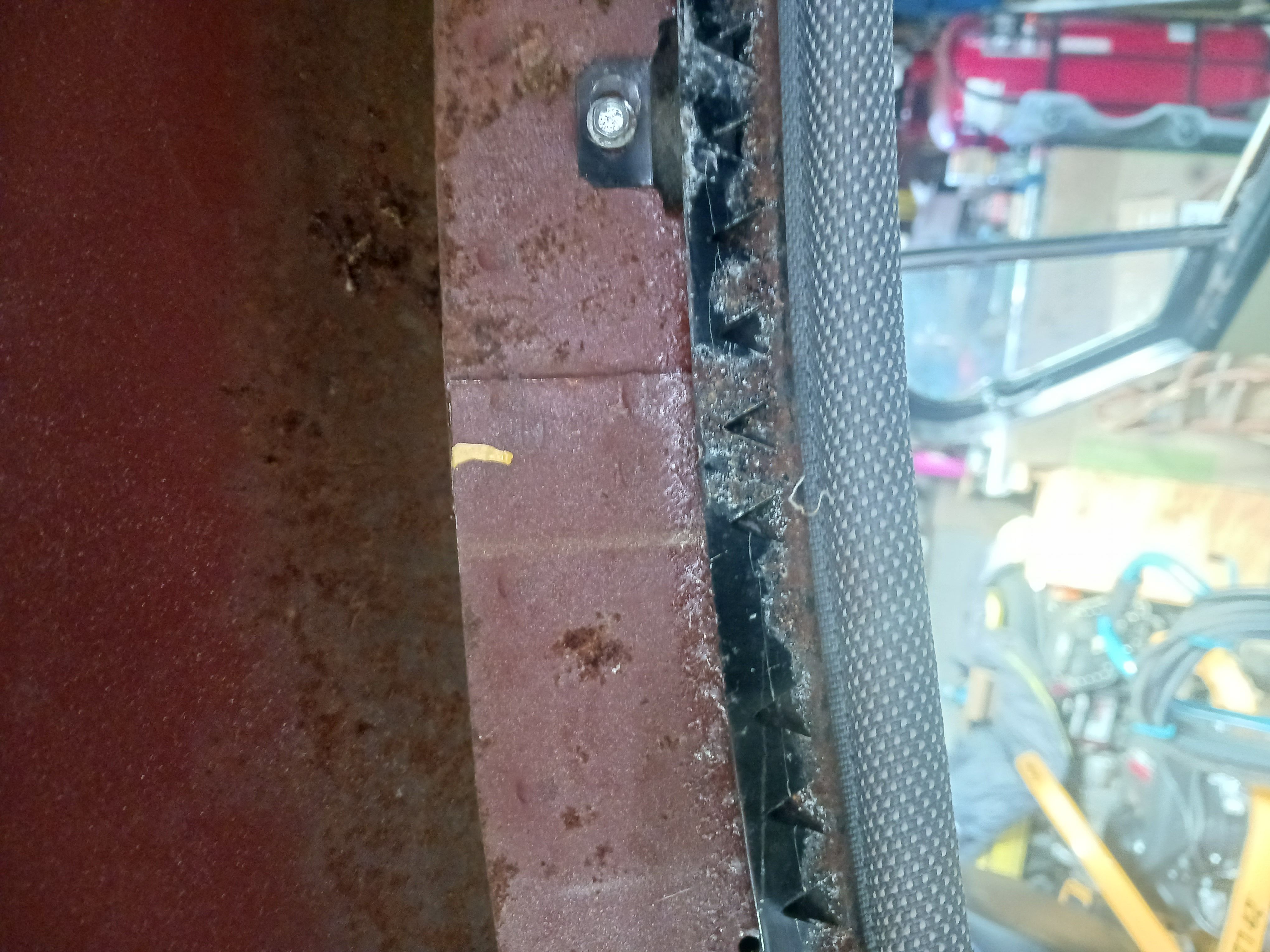

The bow hole above lr door is in a channel
I assume headliner fabric was clamped to the bow end. The extra fabric was tucked into the sawtooth metal tack strip along the sides and glued front and rear.

Looks like there must be an upper windshield trim to cover the front of the headliner. If there is no trim the material must go in under the windshield rubber. The rear around the back glass could also be the same. As for the sides, not quite sure what hides the edges.
