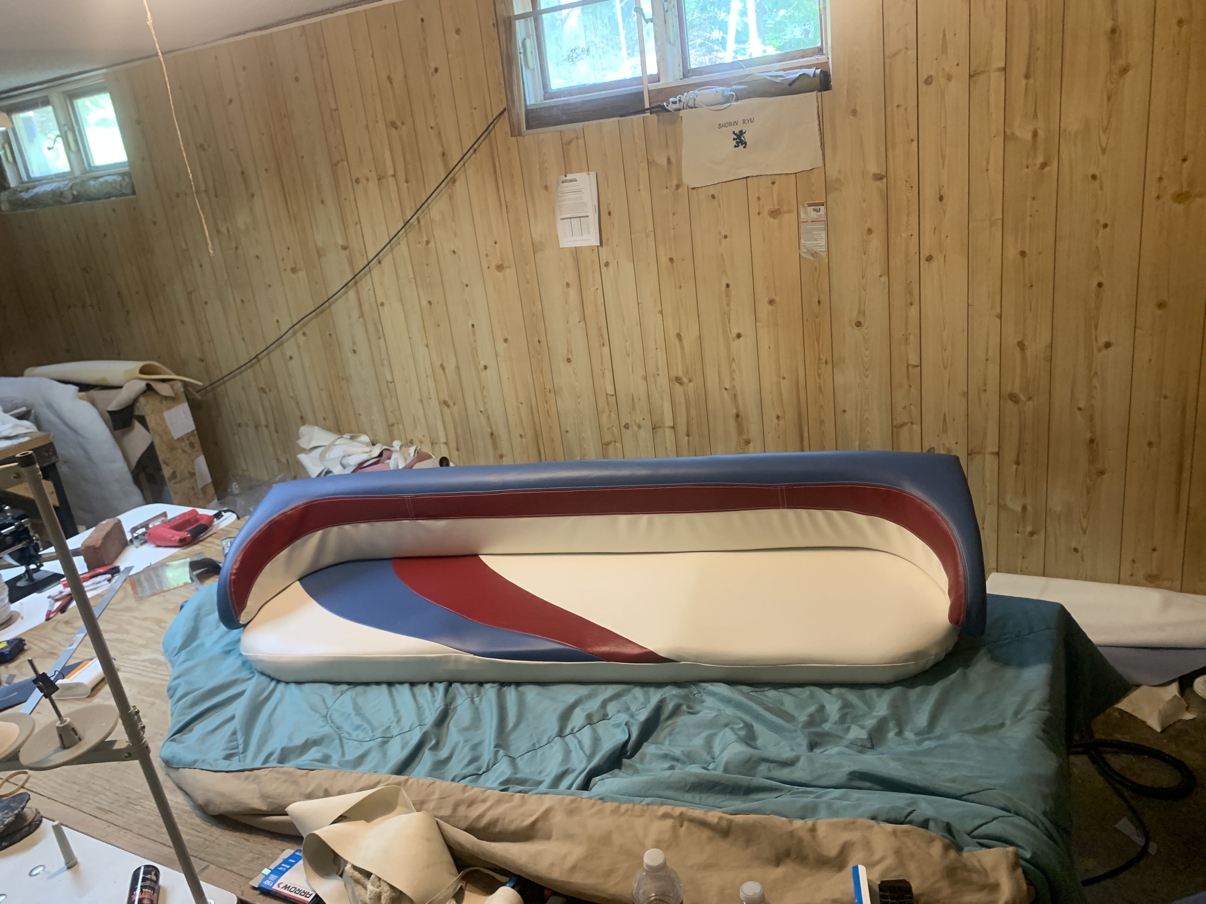

Well. I have done a few. I know the foam is about an 1/8 inch larger than frame. Using the pattern as an example. If I get it a little smaller than it actually was. I’ll be fine. Getting it to big and it not fitting back in the boat , not good. I know it’s a 1994.
#17757

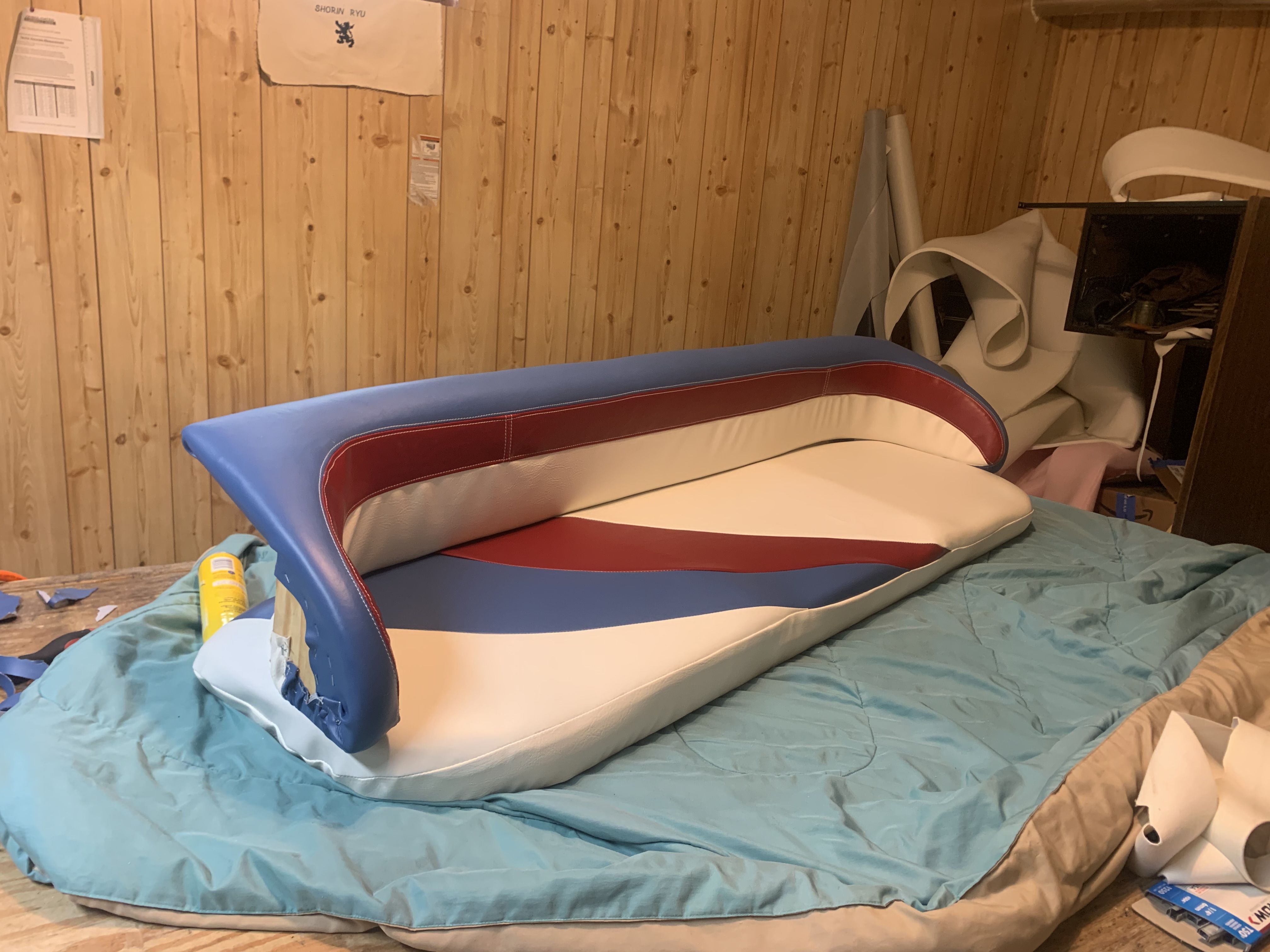

I hope I don’t have many of those. They brought the back part later. It was fiberglass. Still had to replace wood on the ends. Replace the staple strips on the back. I had to heat the fiberglass up to get it to take a staple. I guess there is a trick to that.
