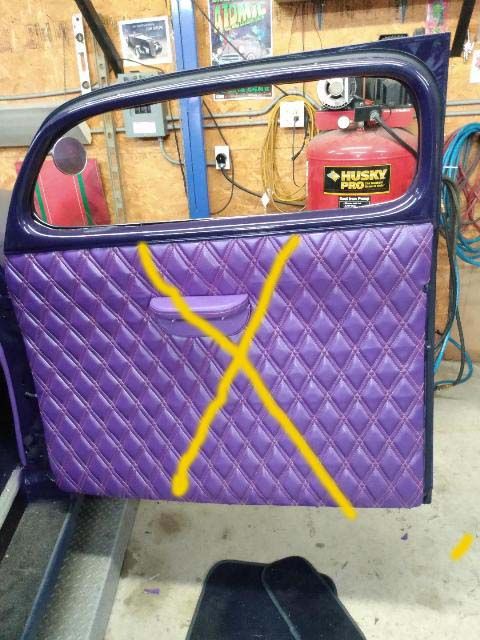

After a few jobs with rolled pleats and diamonds, I quit using glue. With pleats I staple several places around the perimeter and start in the middle and work my way out to the edge, flip material, start in the middle again, work to the edge. With diamonds, staple the edges, make a full length Xs in the middle and work towards the edges, flip and repeat until finished. Your mileage may vary.

@LLeeT , I really like that diamond panel. When you say a full length X do you mean the full panel?

What I meant is that I start in the center (for diamonds only) and make a X starting at the edge of the panel and sew from there to the side of the center most diamond to the other edge. Next repeat that step by creating your X . It may have read that I was starting to sew from the center, but that is where I want my first stitches to cross.

#16630
Maybe this will make it more clear. Forgive my crooked X.
