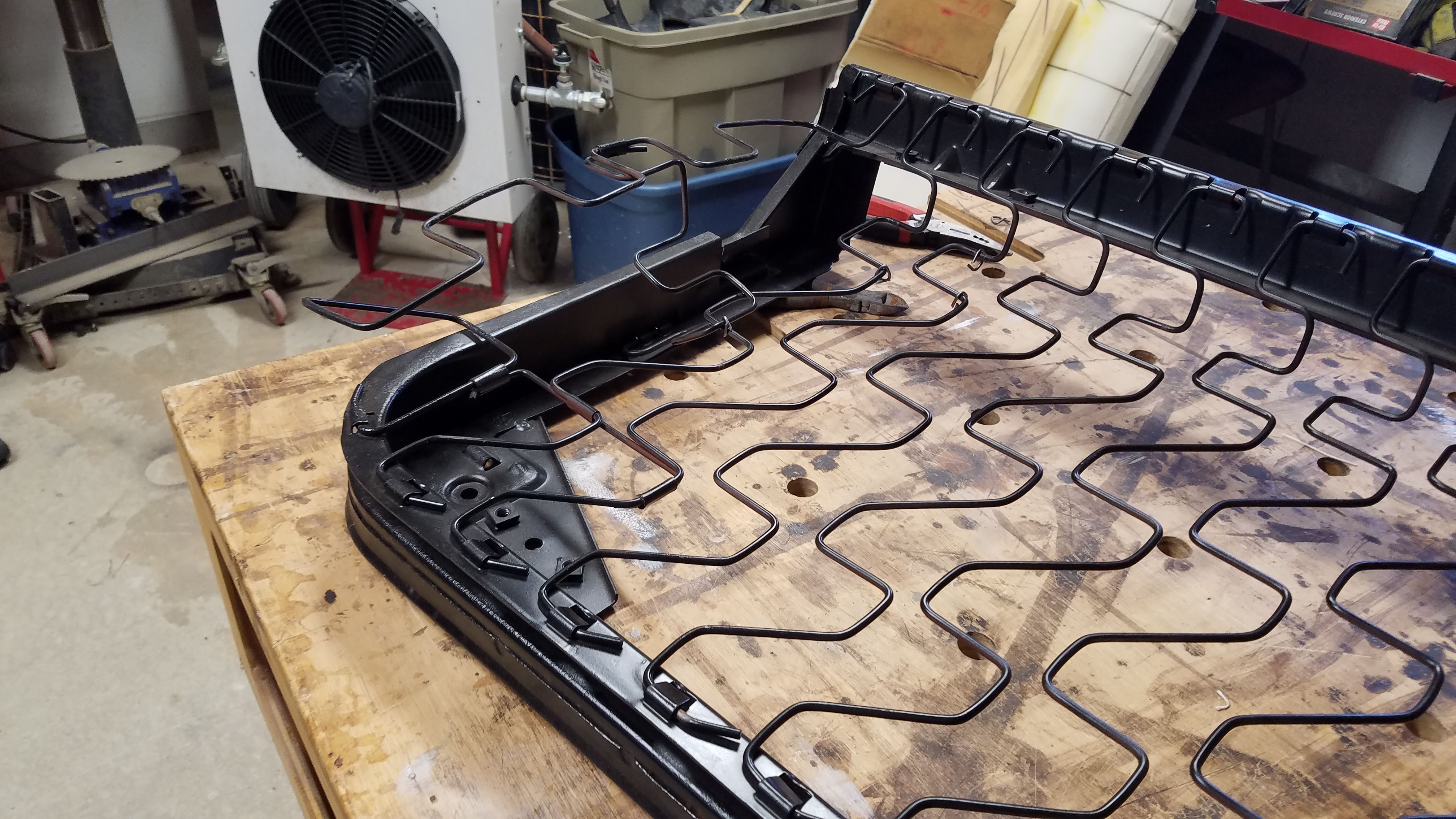

It depends on the style of springs is has on the bottom. Do you have a picture of yours? Normally on the 67-69 seat frames you have to use a wood base because of the style of springs they used. but on the 70-72 frames you can reuse the the factory zig zag style springs.
By Ray

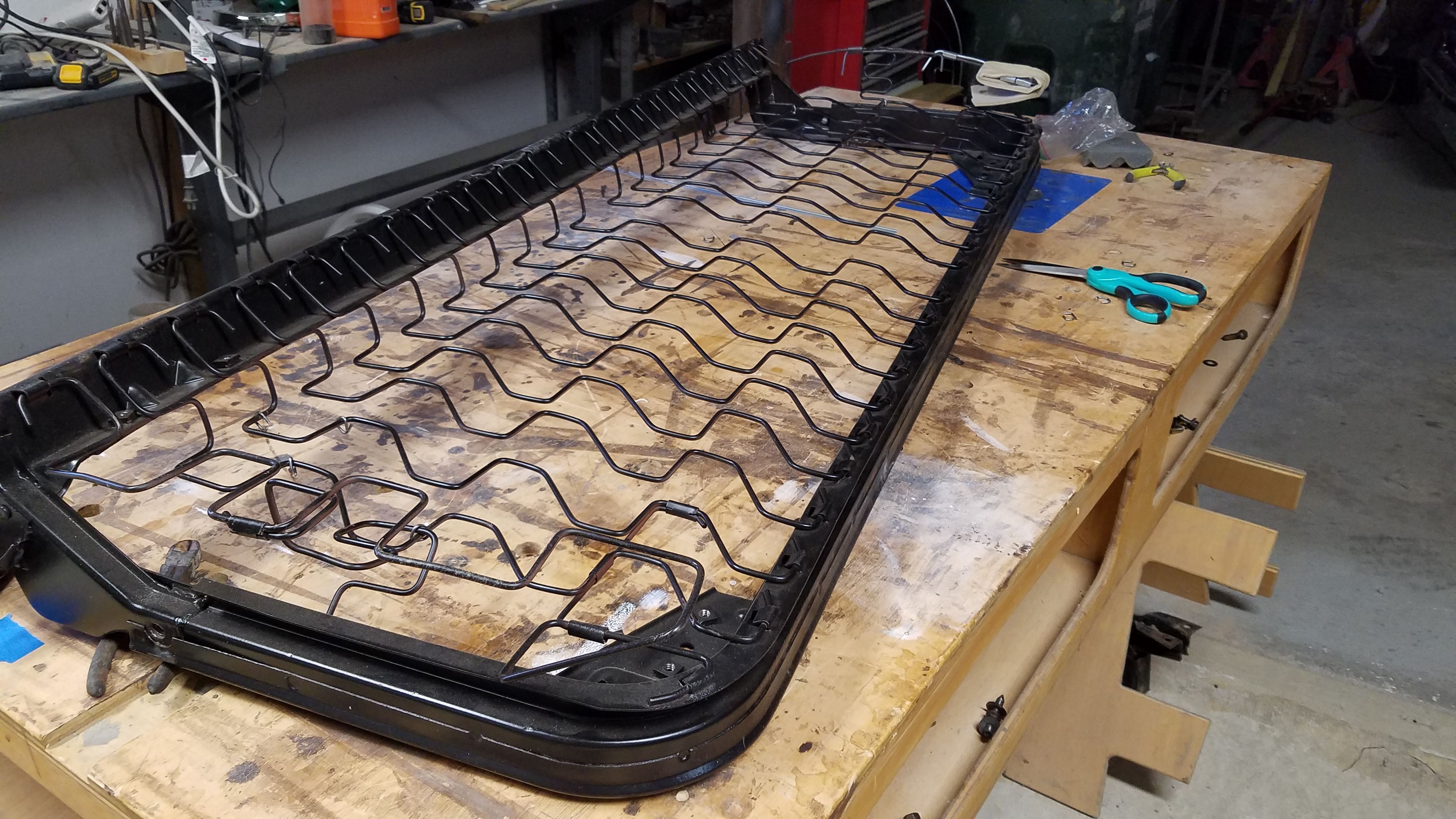

#14754
Here is what my bottom frame.
By Mikesimpson
#14757

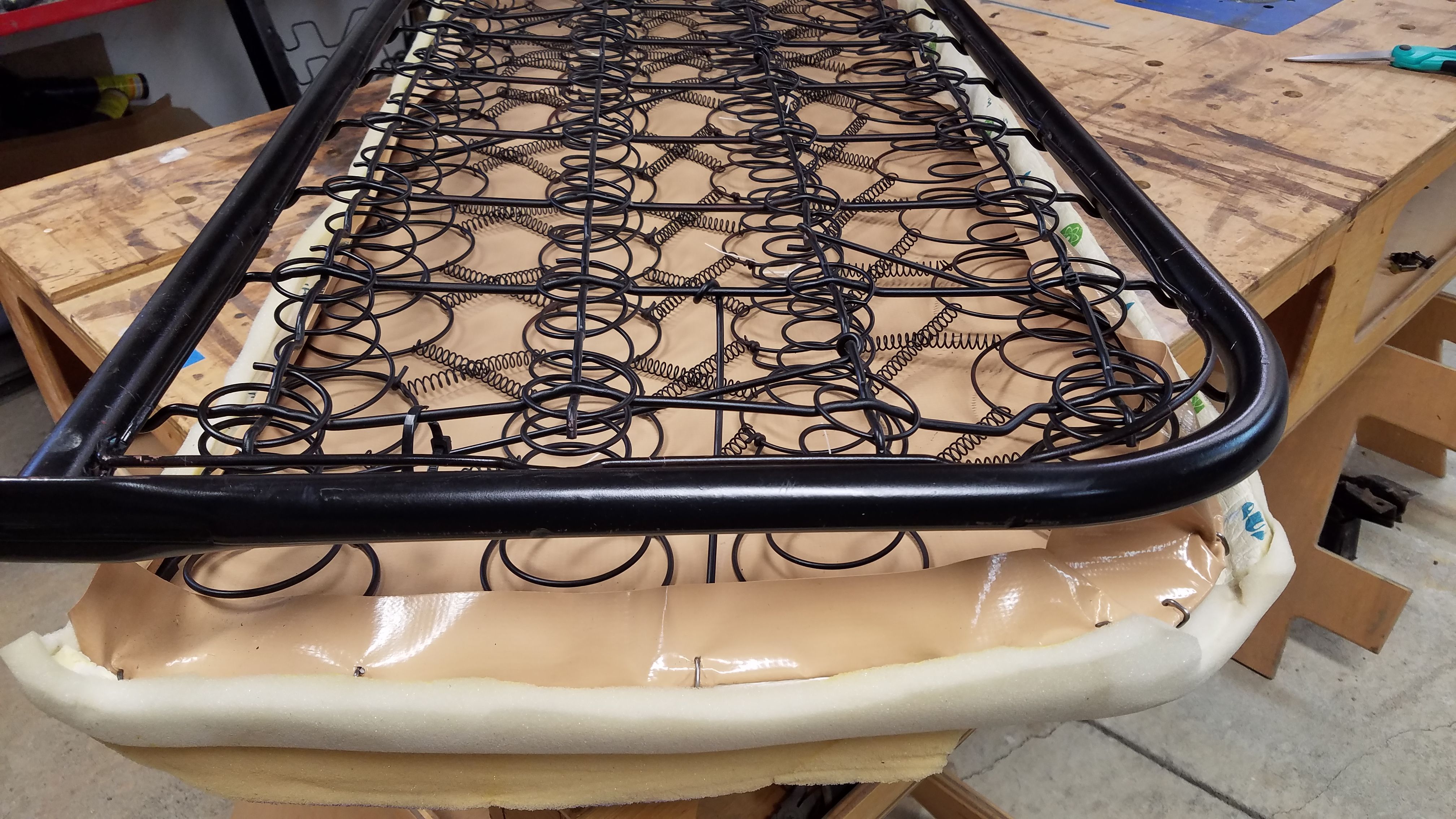

I would do away with those outer springs that stick up higher than the rest. Then you will have a flat surface to start with. Keeping the rest of the stock spring system will make for a nicer ride than using a solid wood base. I run a row or two of jute webbing from side to side to stiffen it up a little bit, that’s just my personal preference. Then I do a layer of upholstery vinyl over the springs, then a layer of jute carpet padding. Then on top of that you can do your foam. I use 2.2 density 50lb compression foam for the bottom cushion. Here’s the bottom of a C10 seat I just finished.
