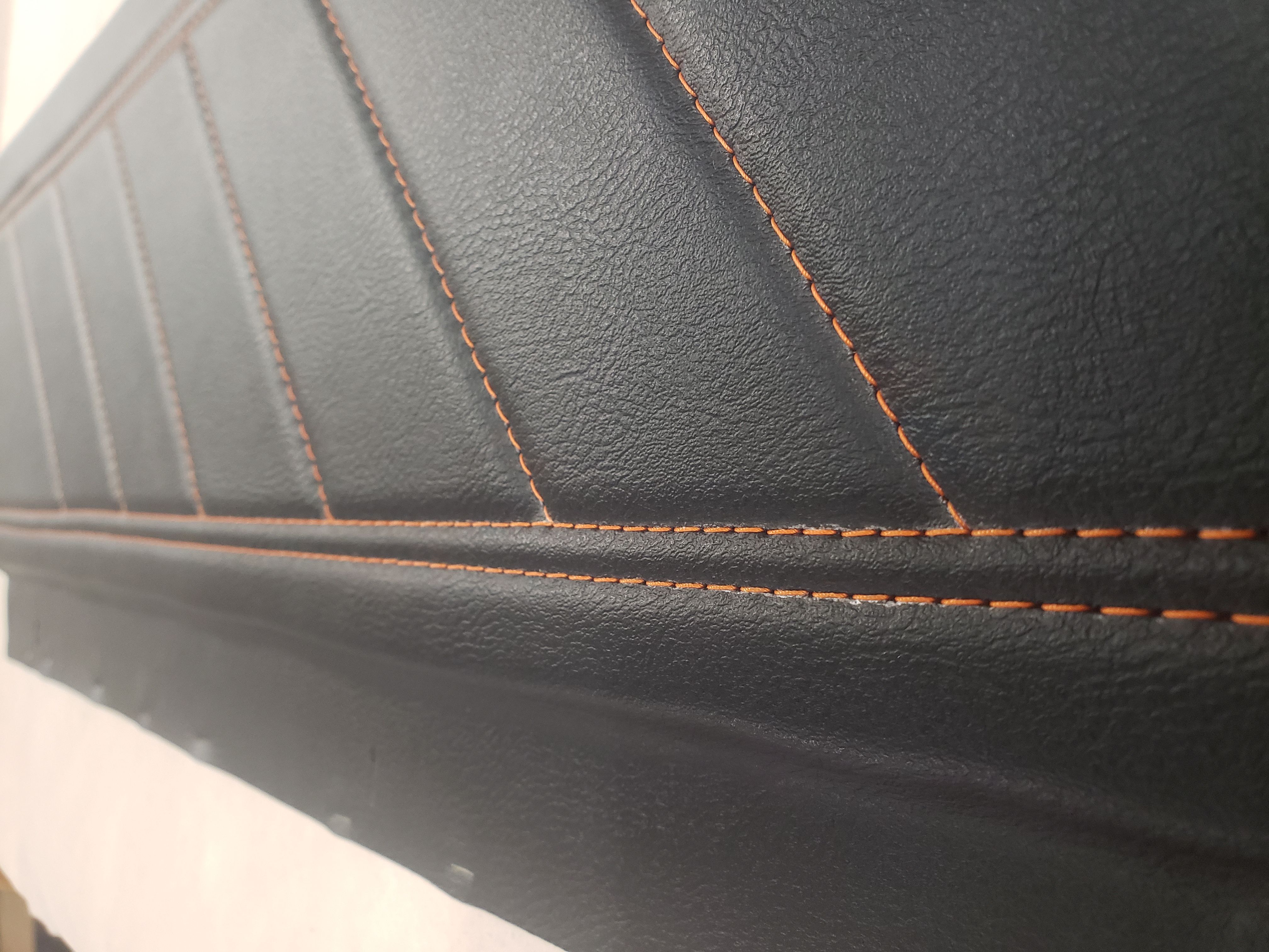

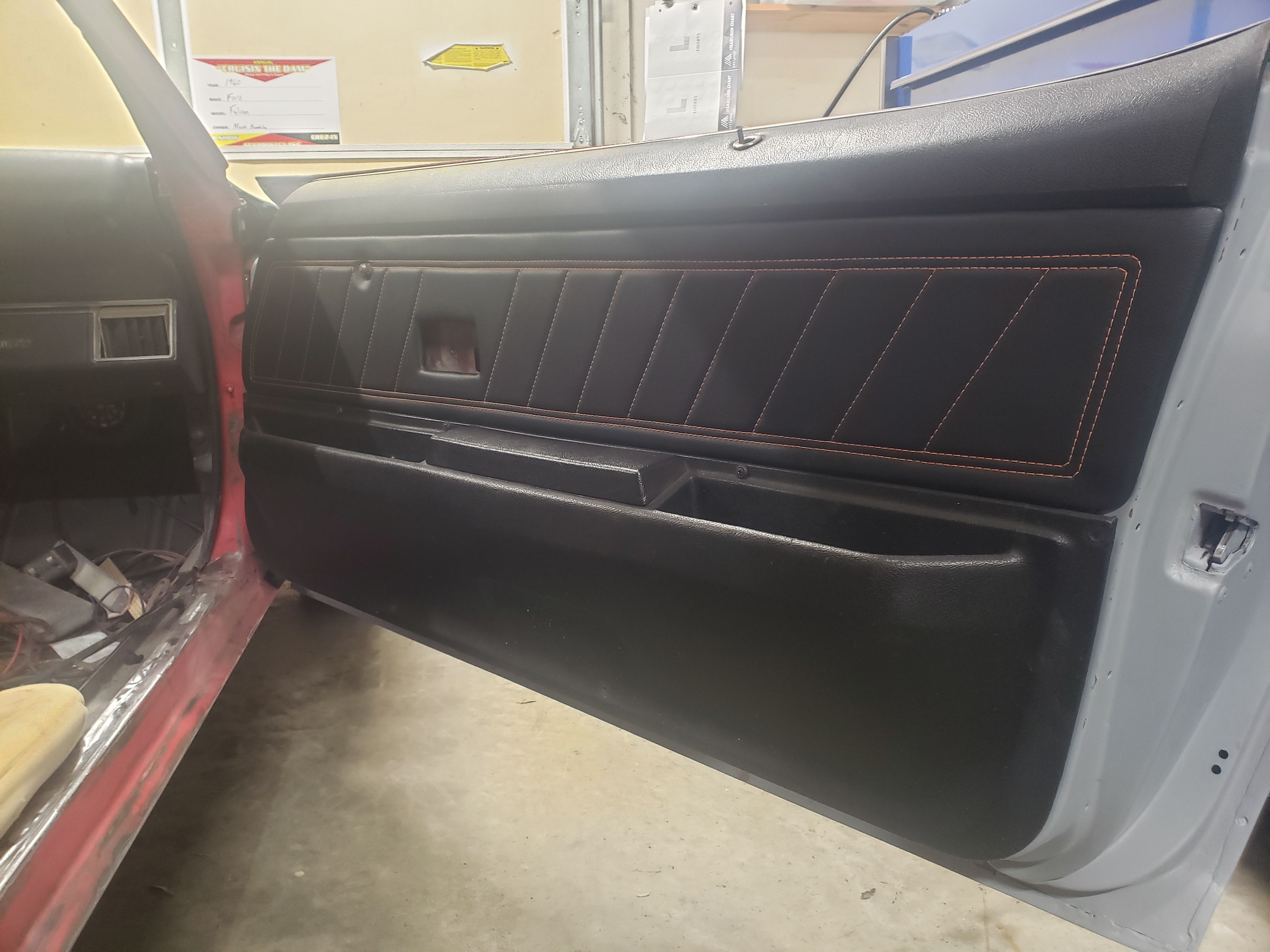

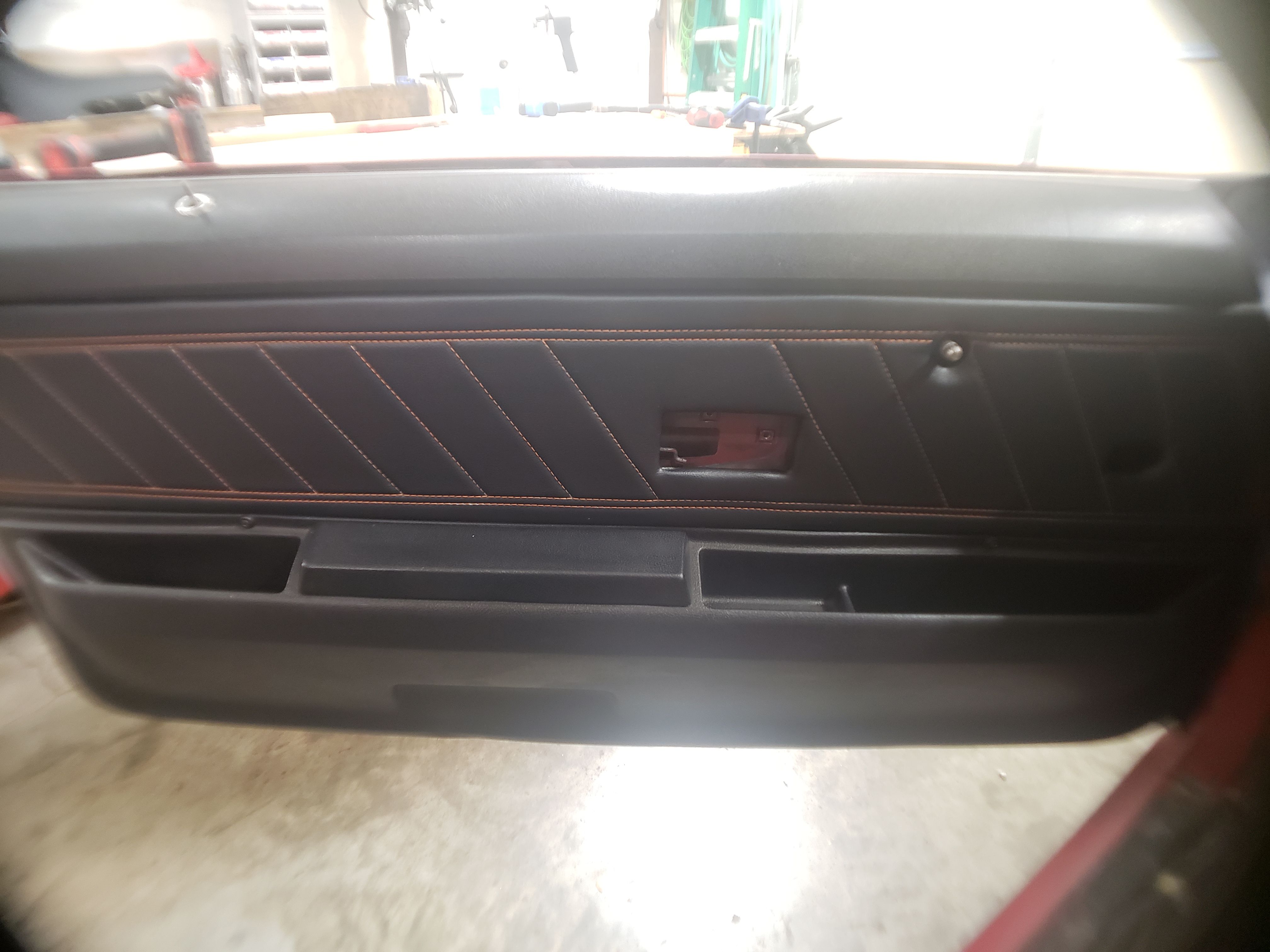

Here are a few pics of some upper door panels i did for a 73 Camaro. Customer wanted custom orange stitching. Normally i don't do too much stitch work on door panels like that, so it made an interesting challenge. I always try to learn new techniques so i can apply them to many projects down the road.
This time i used 1/8" closed cell with a typar type backing material and stitched the pattern to the material. I did this because the machine wouldn't go through the material plus 1/8" ABS. I then glued the stitched material to the board and added a few staples on the inside.
Came out nice i think. I have tried stitching door panels a couple different ways but i think this way proved effective so i may keep it in my bag of tricks.
If you have other suggestions or ideas on how to accomplish this look please let me know. Thanks!

Wow . . . very nice.
Is there a trick to get the top stitch to intersect cleanly where the vertical and horizontal stitching meets?

#14490
Basically i stitch the outer section then measure my pleated section to the size i want. Then just make sure that the stitches will intersect with a needle punched hole. I did have to move my pleats a little here and there just due to variances in the stitch length or the way the foam reacted. You just have to make sure you drop the needle in the existing holes and not in the top stitch. A little tricky and time consuming but makes for a nice look.
