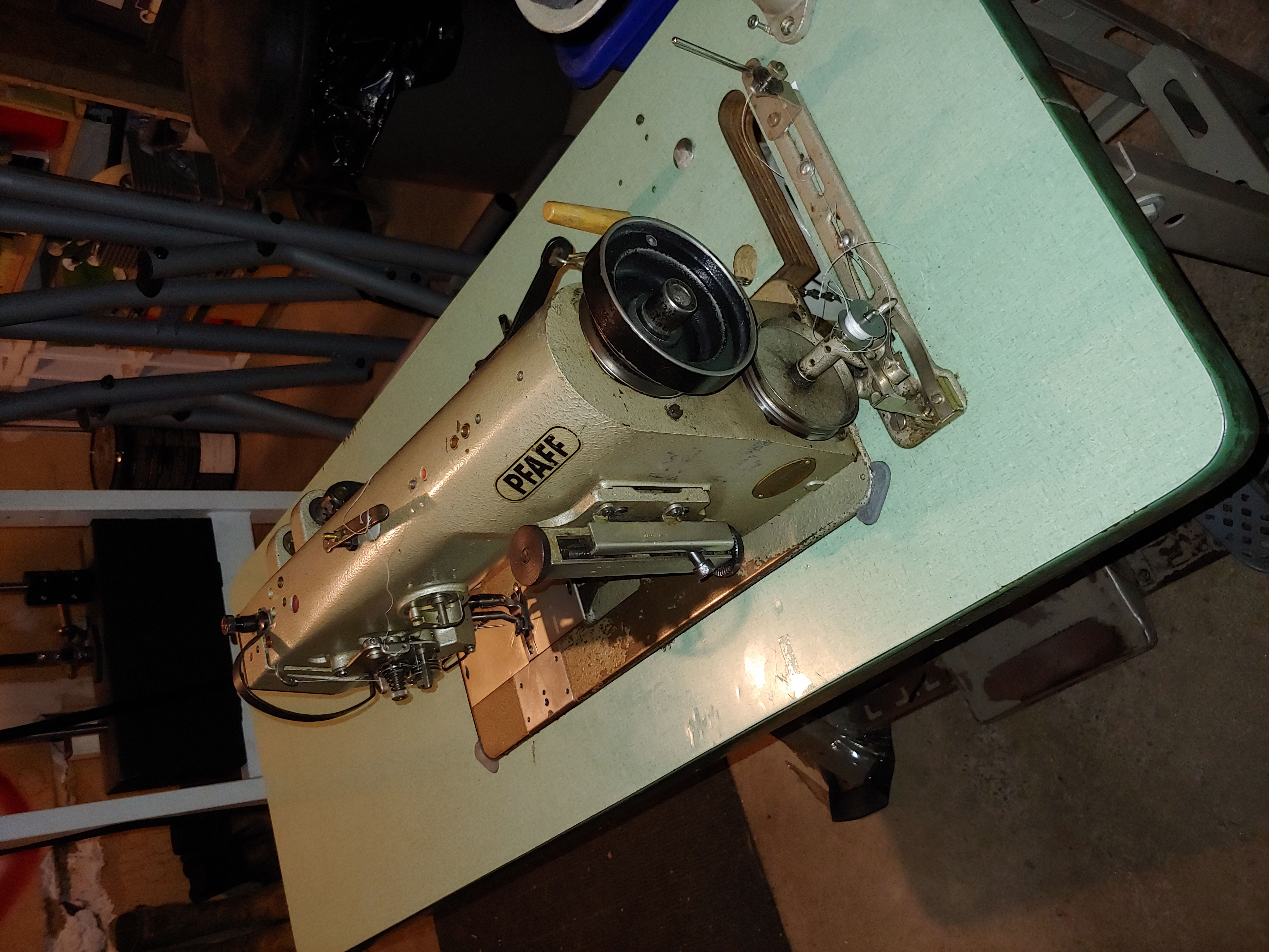

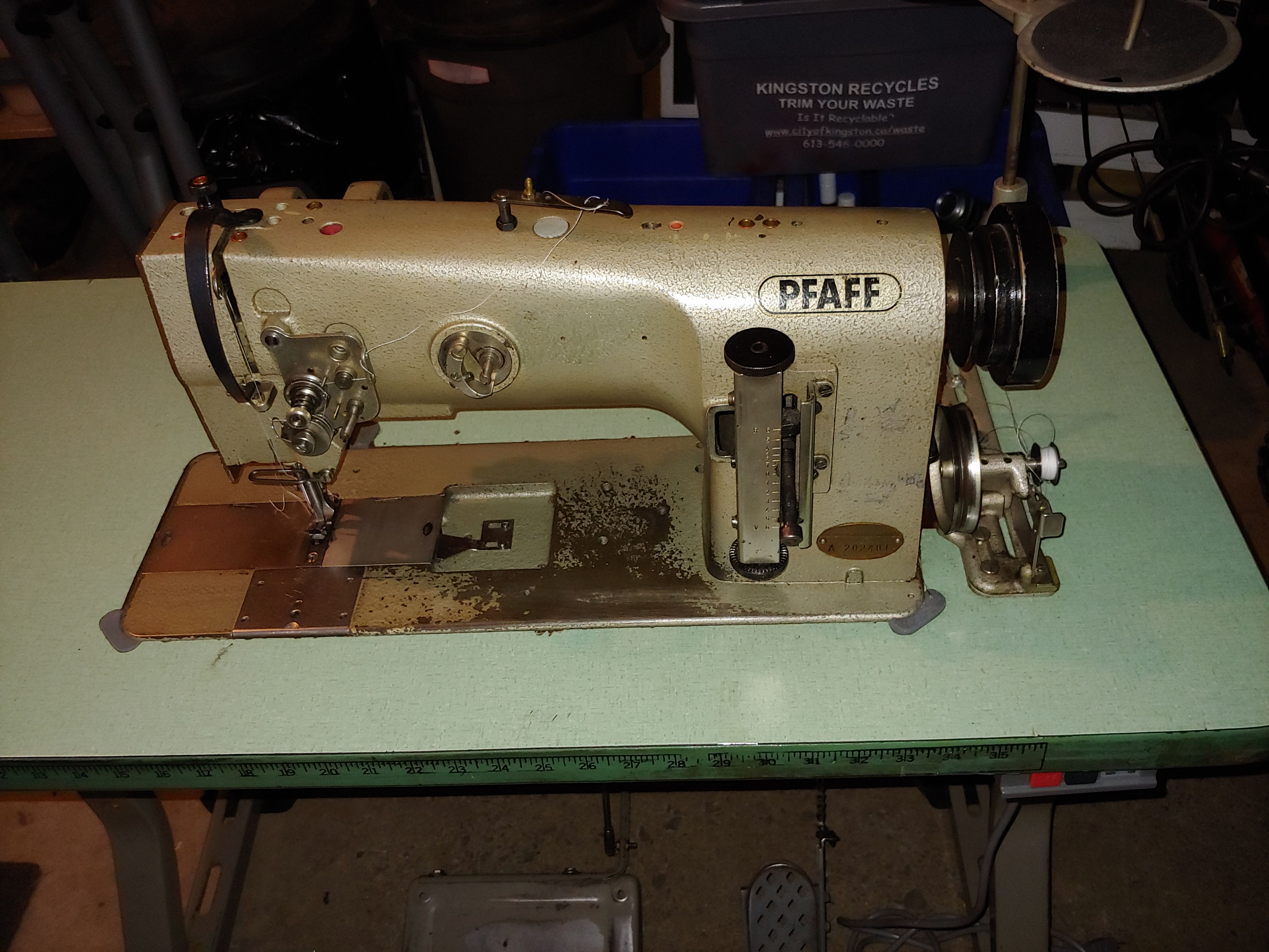

Well decided against the Singer and picked up a PFAFF 1245 . Managed to find needles in a kit from 14-22 (10 in each size) but the cost of shipping the #92 Bonded Polyester is kinda crazy. Looking for an Ontario supplier. Any suggestions from fellow Canadians?

Thats a great machine you picked! You will love it.
