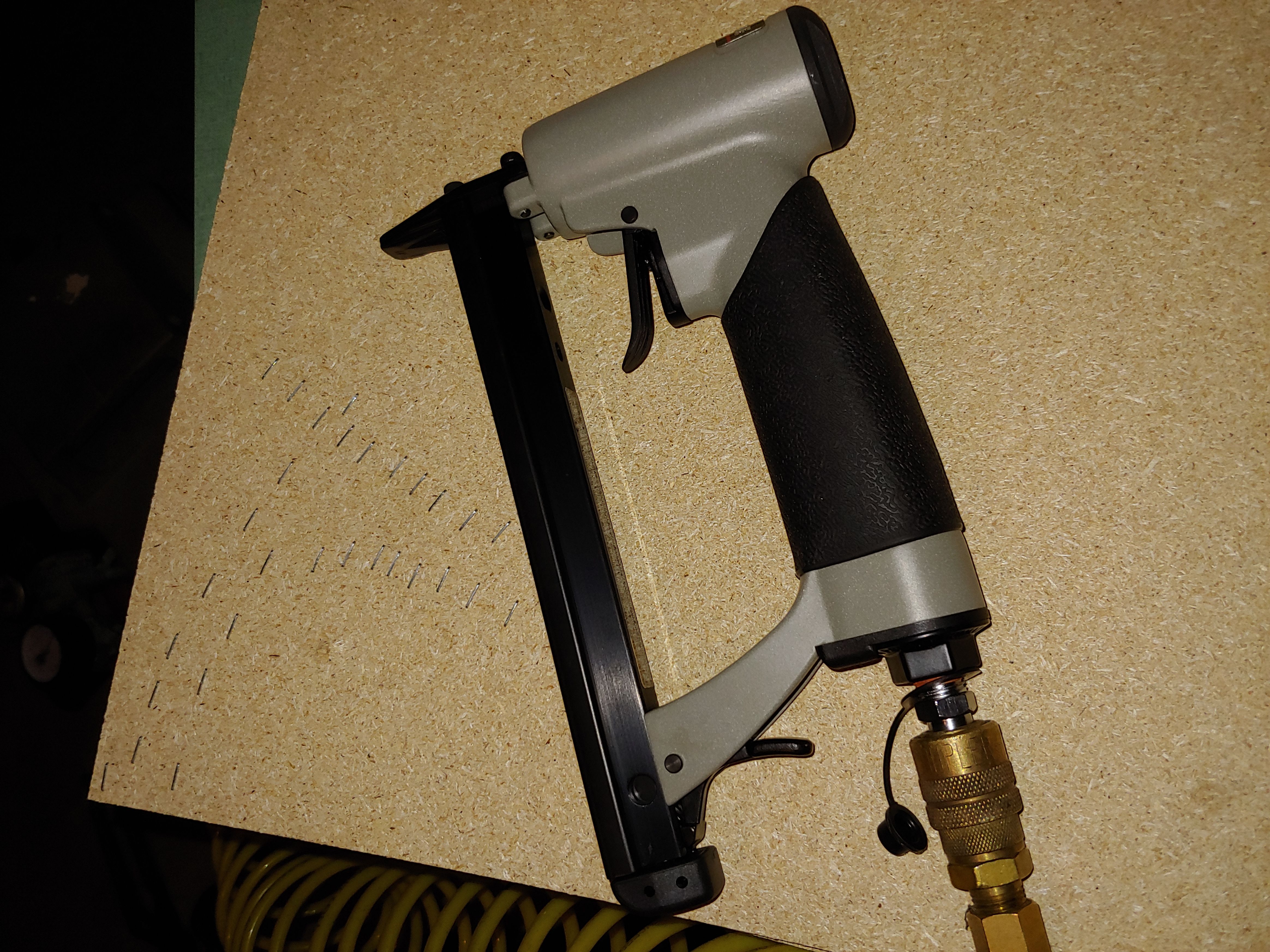

#12320
I have never seen or used that gun. It looks pretty nice and I do tend to like porter cable tools. It does shoot the size staple (3/8 Crown) you want that are most commonly available. It appears to be a close copy of the Bea. If you buy it let us know how you like it. I would love to have a lower cost option to recommend to people just starting out.

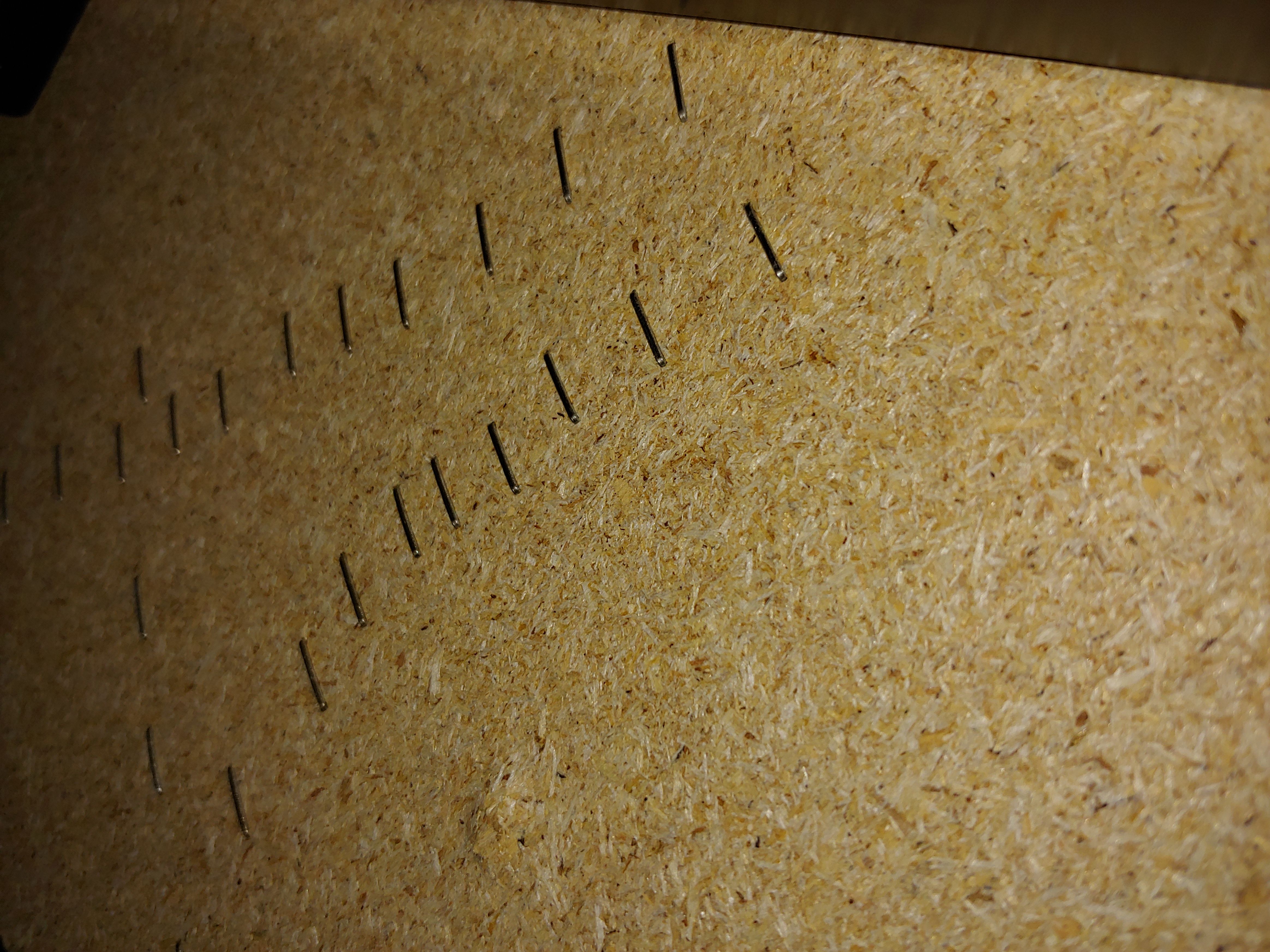

I can only speak as a complete beginner to upholstery but do use pneumatic tools frequently and say that the Porter Cable US58 22Ga stapler will definitely sink the 3/8" and 1/2" staples directly to the basement . It will also fire them across the room at your pets (or maybe your wife?) if you're not careful because it lacks a safety guard.

Going to purchase the 1/4" staples and maybe even the 5/32" that John suggested and see if it handles those as well.
