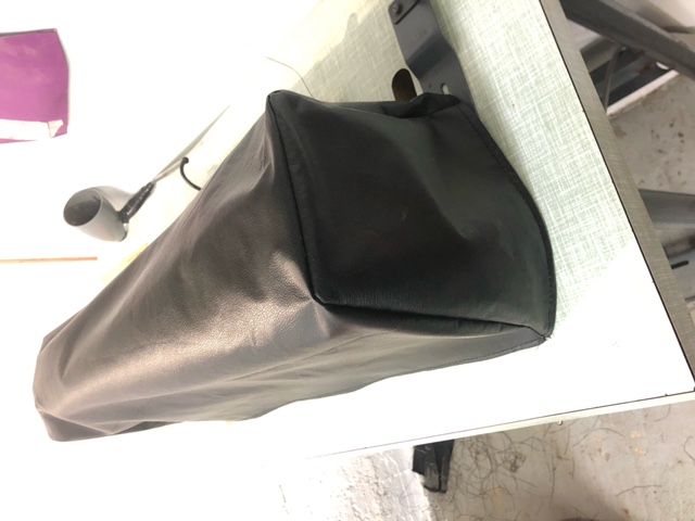

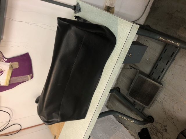

My first project being a vinyl cover for Doris. To keep her clean and safe. Measured and cut out one main section and two ends. 1/2” seams all around. Plan being to sew inside out.
Spent about 30mins setting up the top tension. Once happy I started with the bottom hems then added the side panels. Managed to get some reasonable control over the needle speed but a servo will almost certainly help me.

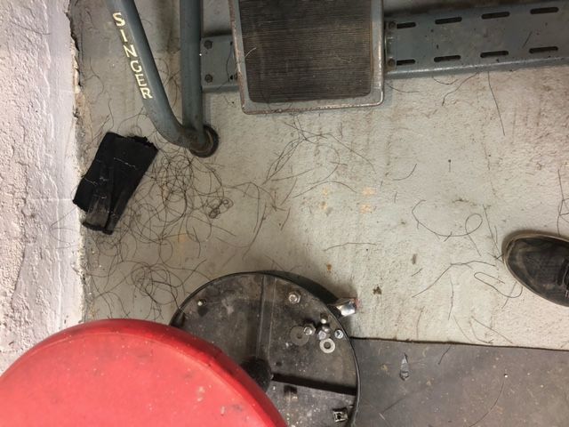

On well, time to thread a new bobbin - that is where the fun started. Before I restarted on my project I decided to do a trial run and disaster, massive birds net on the underside of the thread. Re checked the bobbin, all ok, tried again. Still a mess.
With my limited knowledge, I deduced it had to be thread tension ( unlikely to be the bottom I thought) so I tightened the top. No difference - regardless of adjustment I just seemed to be making no difference, and every attempt ended up with a birds nest. Frustrated I re threaded the machine. More adjustment and this time it seemed to be making a difference. Wasted a complete hour :disappointed:
Not sure what I did or didn’t do.
By the time I had the problem sorted tthe bottom bobbin was empty again. Luckily I had wound a spare bobbin. So finished off my last seam.
MASSIVE learning curve for me. But hopefully I will learn from this.
Anyway a couple pictures of the finished cover - it’s nothing special however a step forward for me. Genuinely pleased with myself :hugging:
And a picture of the mess on the floor from all the wasted thread :scream:

Your machine cover looks great! Especially for it being the first piece you made on the machine. When you start sewing you seam are you holding tension on your top and bottom thread with your fingers? If you don't hold the thread tight enough until you do your back stitch you will end up with a big birds nest of thread as you described.
#12359
That looks great for only a few hours of sewing! I was going to ask the exact same question as @Mikesimpson :thumbsup:
