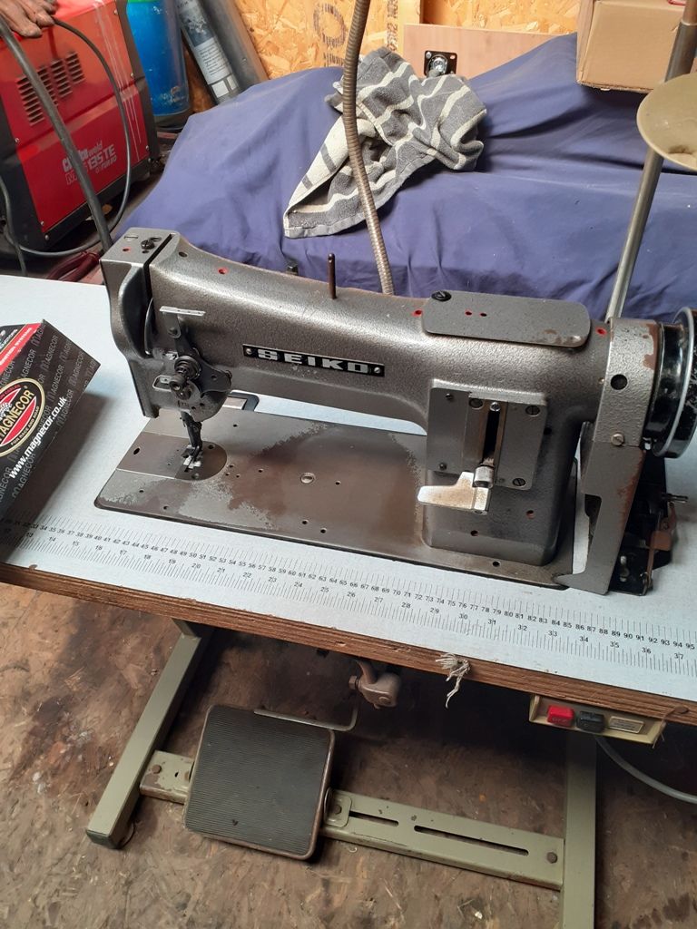

#10861
Thanks for all the advice guys. Invaluable as always.
I managed to find an absolute bargain here in the UK. I think Covid19 may have actually helped. A local upholstery place was having a clearout, due to it being quiet and I picked up this Seiko machine for £150GBP.
I have had a play and obviously practice is the key, but I can notice the difference. My sewing feels a bit more controlled and accurate.

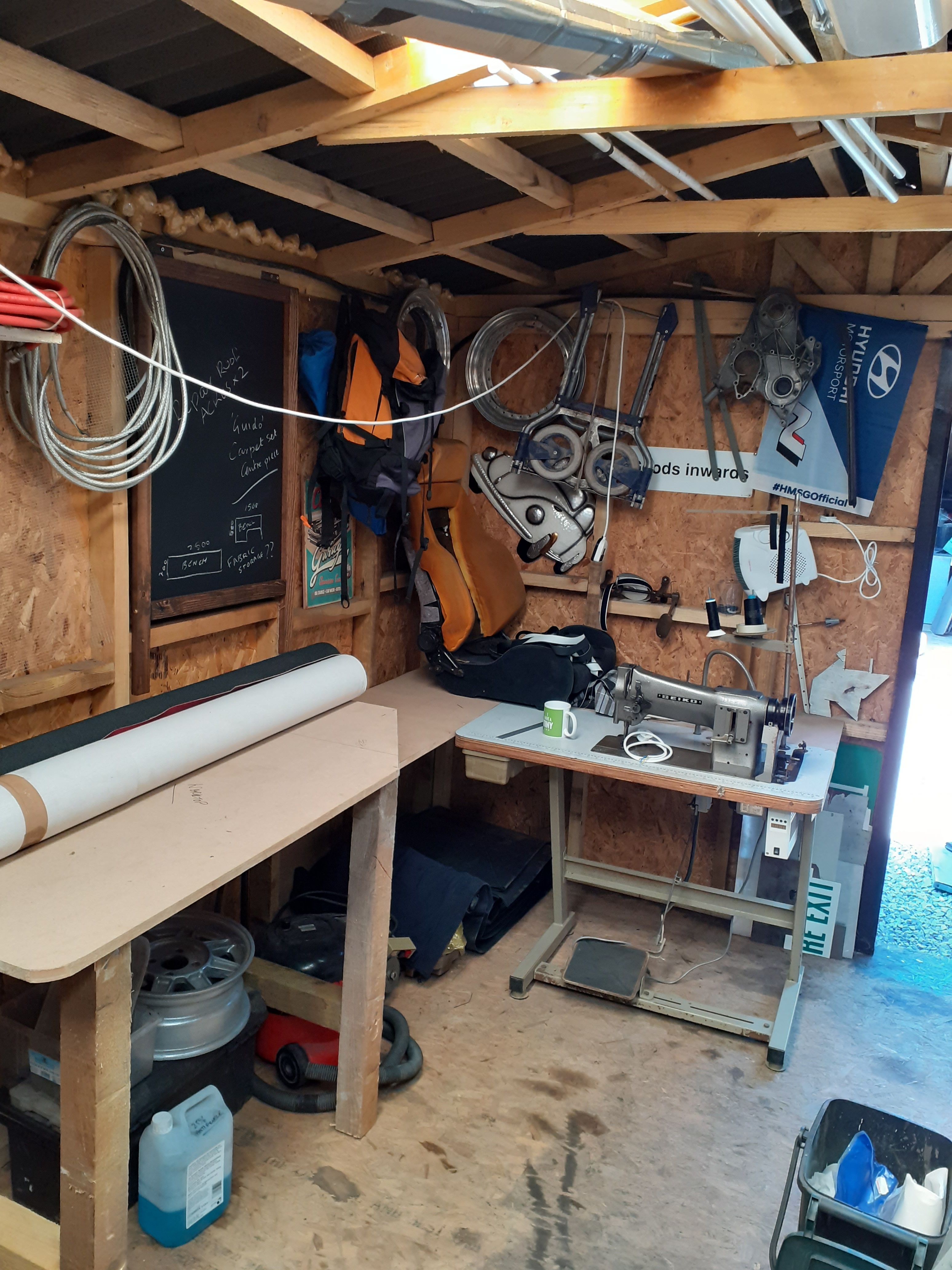

By B1N9S
#10862
I have even gone nuts and cleared the corner of my workshop and set it up for sewing stuff !!!
By Yalan-UK
#10867
That is a good price.... I guess you live in the midlands! I’m down on the south coast and I waited six months for something to come up at a reasonable price. And even then I had to part with £300 (which I thought was a steal!)
I see you’ve already gone out and upgraded to a servo!
