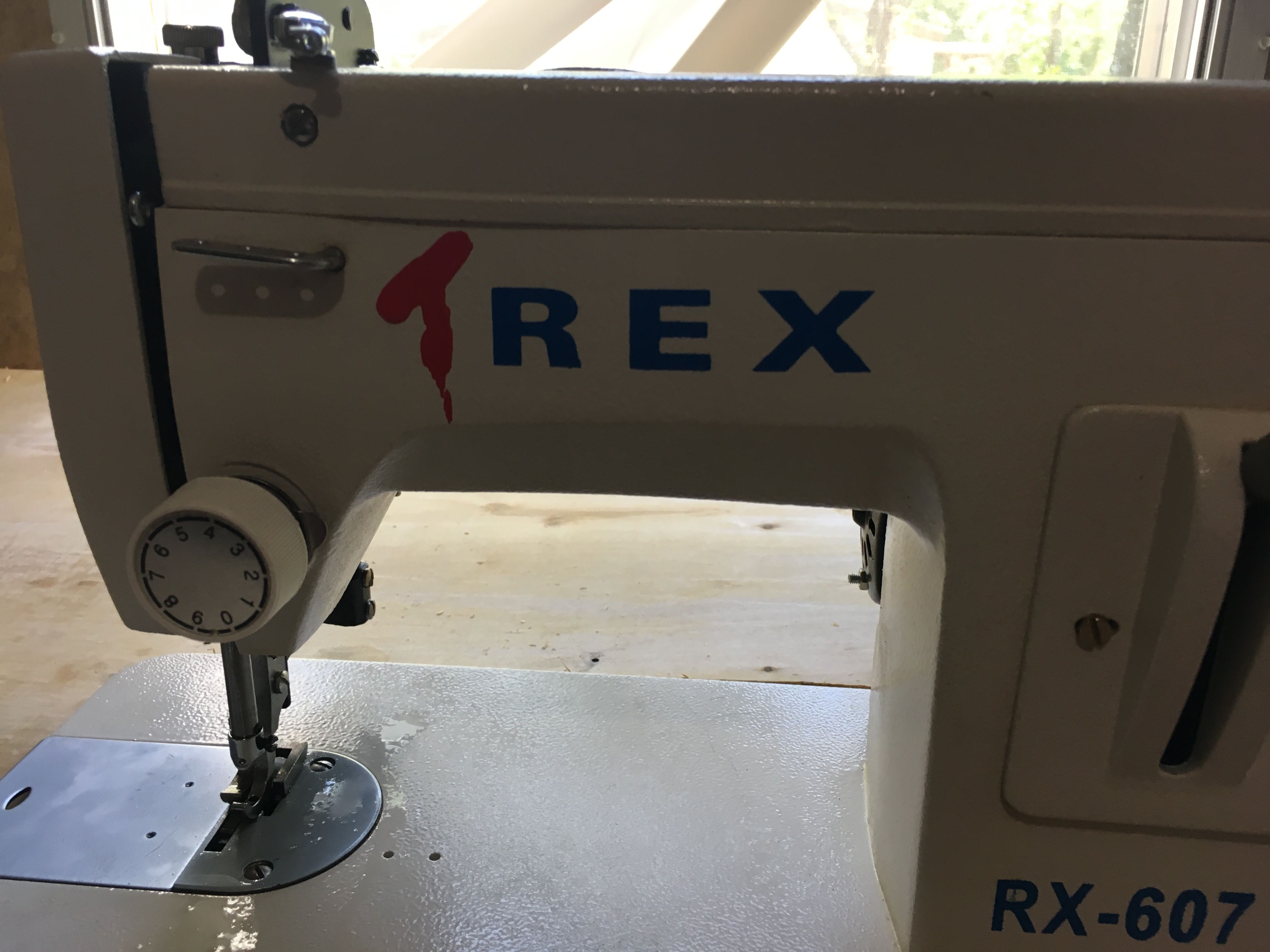

By Kra z Bill
#2242
My son-in-law wanted me to redo some seats in my Grandsons El Comino. I told him that I did not have the correct type of sewing machine to do upholstery work. He found a machine on Amazon called a REX 607, which is made in the same factory as the original Sailrite LS1 . The new LS1s have a lot of up grades the the REX does not have. The REX is kind of a Dinosaur compared to the new LS1, which is why I painted a big red T in front of the name. Parts from the LS1 fit and work great on it, I am slowly up grading it to the quality of the sailrite. But after seeing the review that John did on the Fabricator, I may have to start saving my money.

By Kra z Bill
#2247
OhioFitnessGarage wrote: Wed Aug 08, 2018 1:39 pm @Kra z Bill, can the speed be adjusted?
No not with the motor it came with. In fact it is a portable machine. I plan to mount it to a table and get a Sailrite workhorse motor and put under it.
