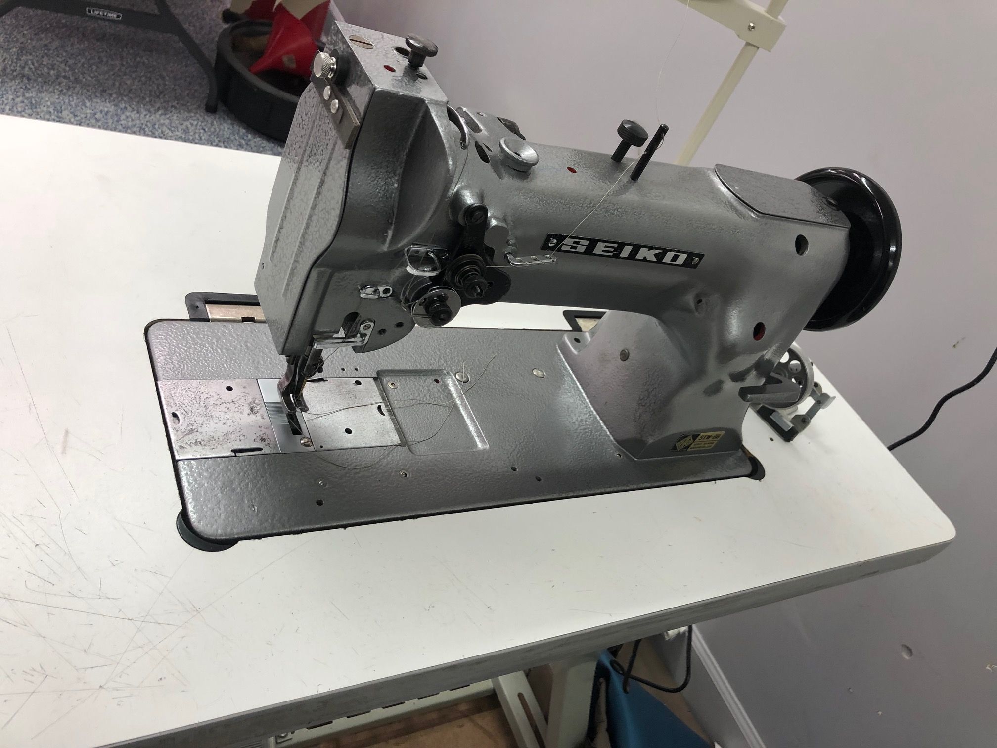

I decided to do some service and paint job to Seiko I got. Results so far :)
Going to replace some small parts and see if I can make it sew again

Finally alive. Every adjustment that could be misadjusted - was screwed up. Got it to sew and it runs! Any speed, 4-6 layers of leather or as much as I can put under feet - no problem.
Still need to do some tiny adjustments to make reverse stitch just perfect, other then that - it's running good now.

Looks Awesome @IvanD !! That seiko is lucky to have such a good owner!

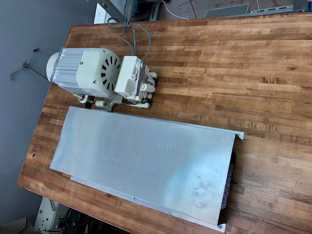

My "sewing machine table" project is completed now! It's little bit too much and I wouldn't do it again but I love end result.
Had to make my own aluminum pan, installed better motor, 1100W with needle positioner and 24V for knee lift (might add that too).
My other machine (Seiko above) is for sale in St. Louis complete with table/servo if anyone looking.
