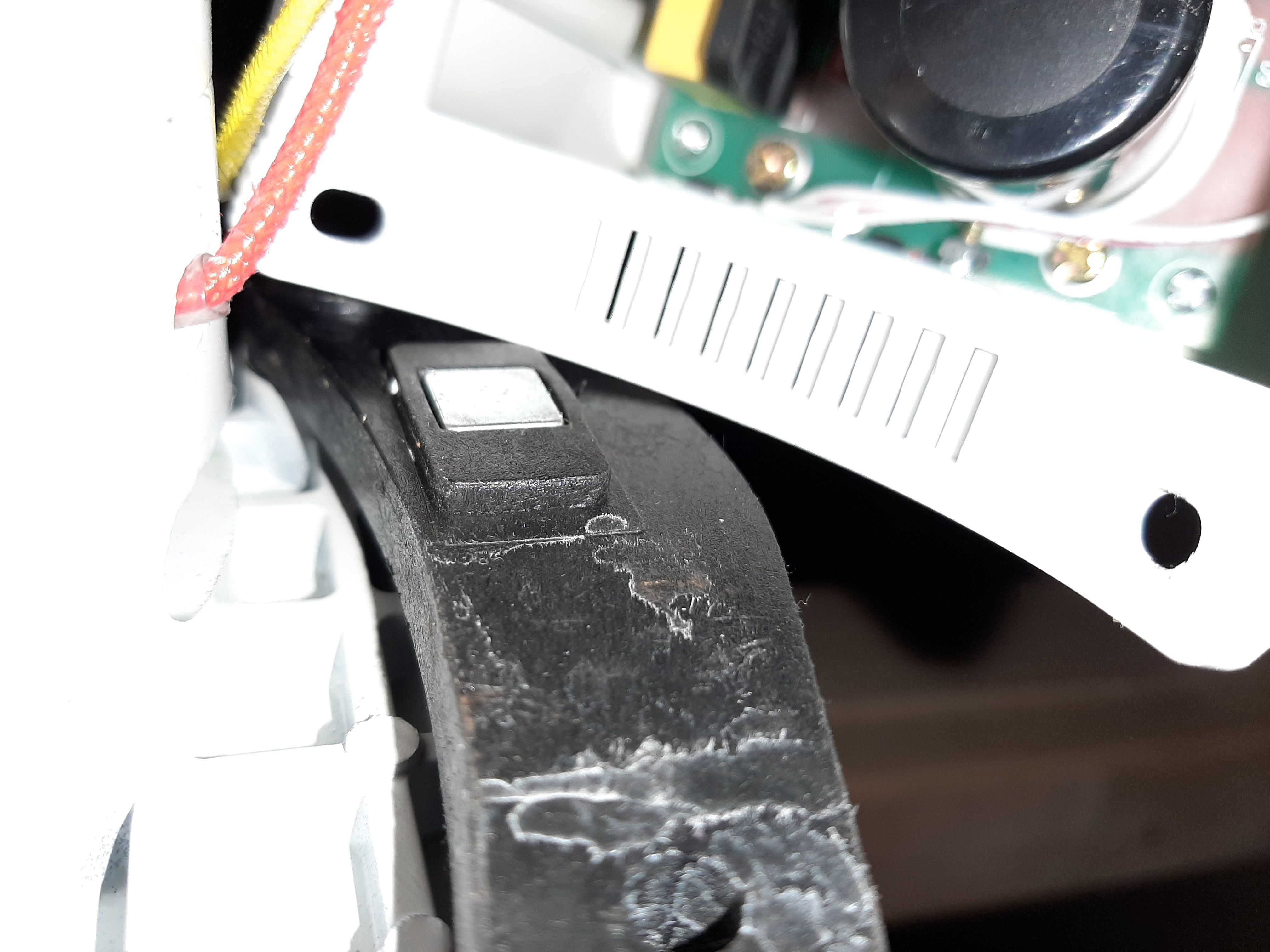

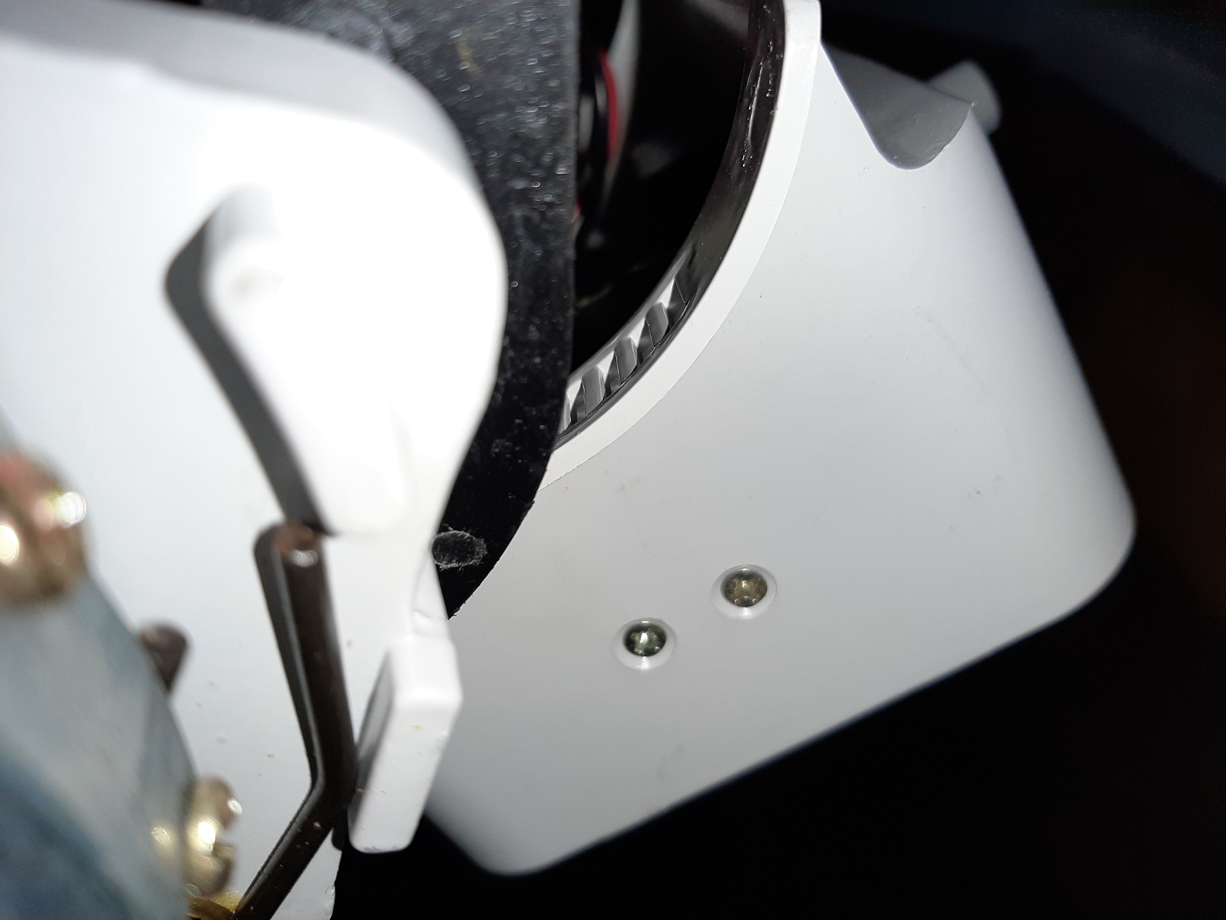

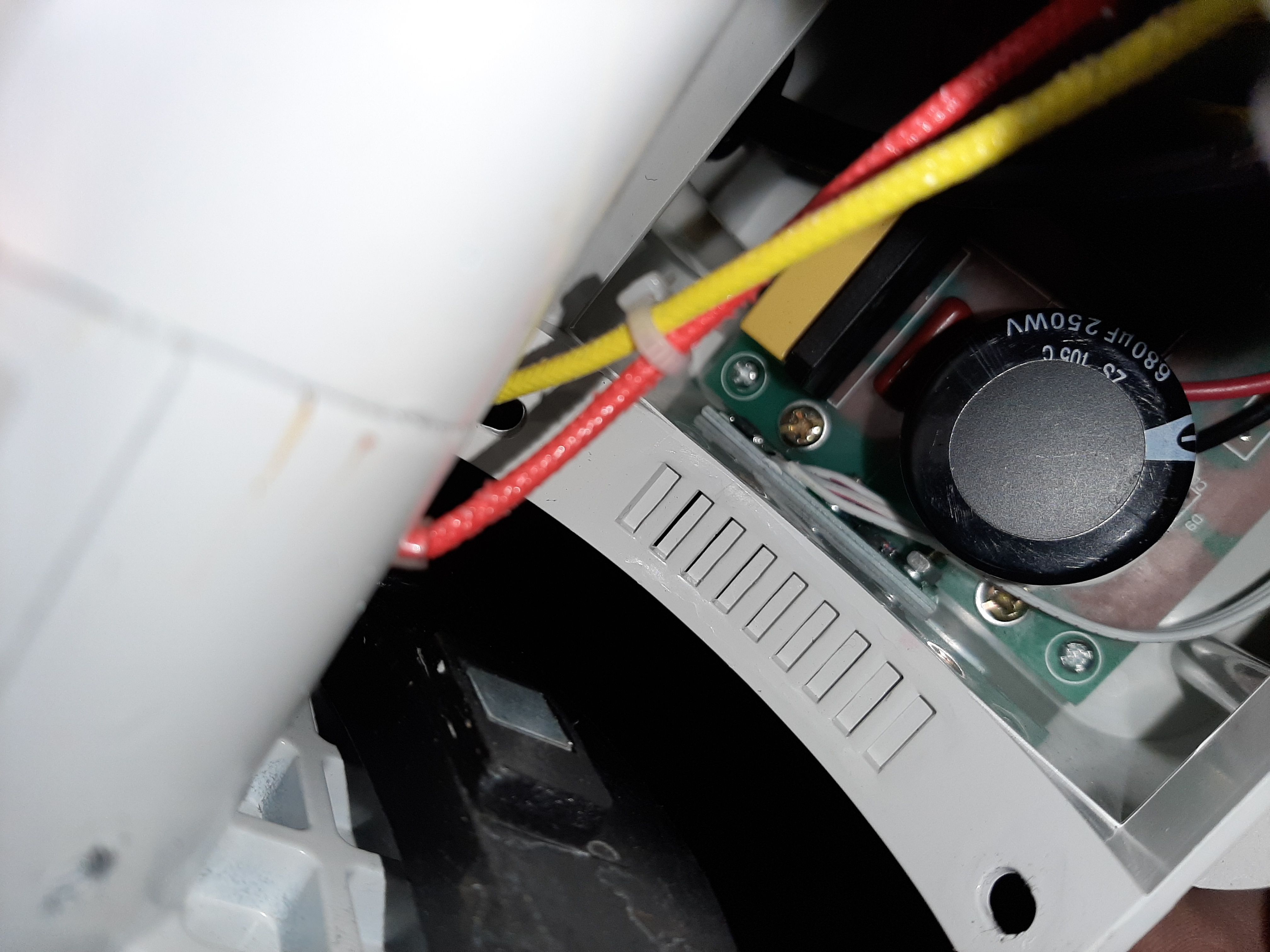

#6307
John Long wrote: Sun Nov 03, 2019 12:23 am @miket, I'm not sure if that is true or not. It will be a simple thing to take out four screws and look inside. If there is a light and interrupter vein, it should work.
This is what I found.
Looks to be a magnet
Last pic is arm, 2nd pic is the 2 screws that hols the sensor next to arm, 3rd pic is sensor and arm
By miket
