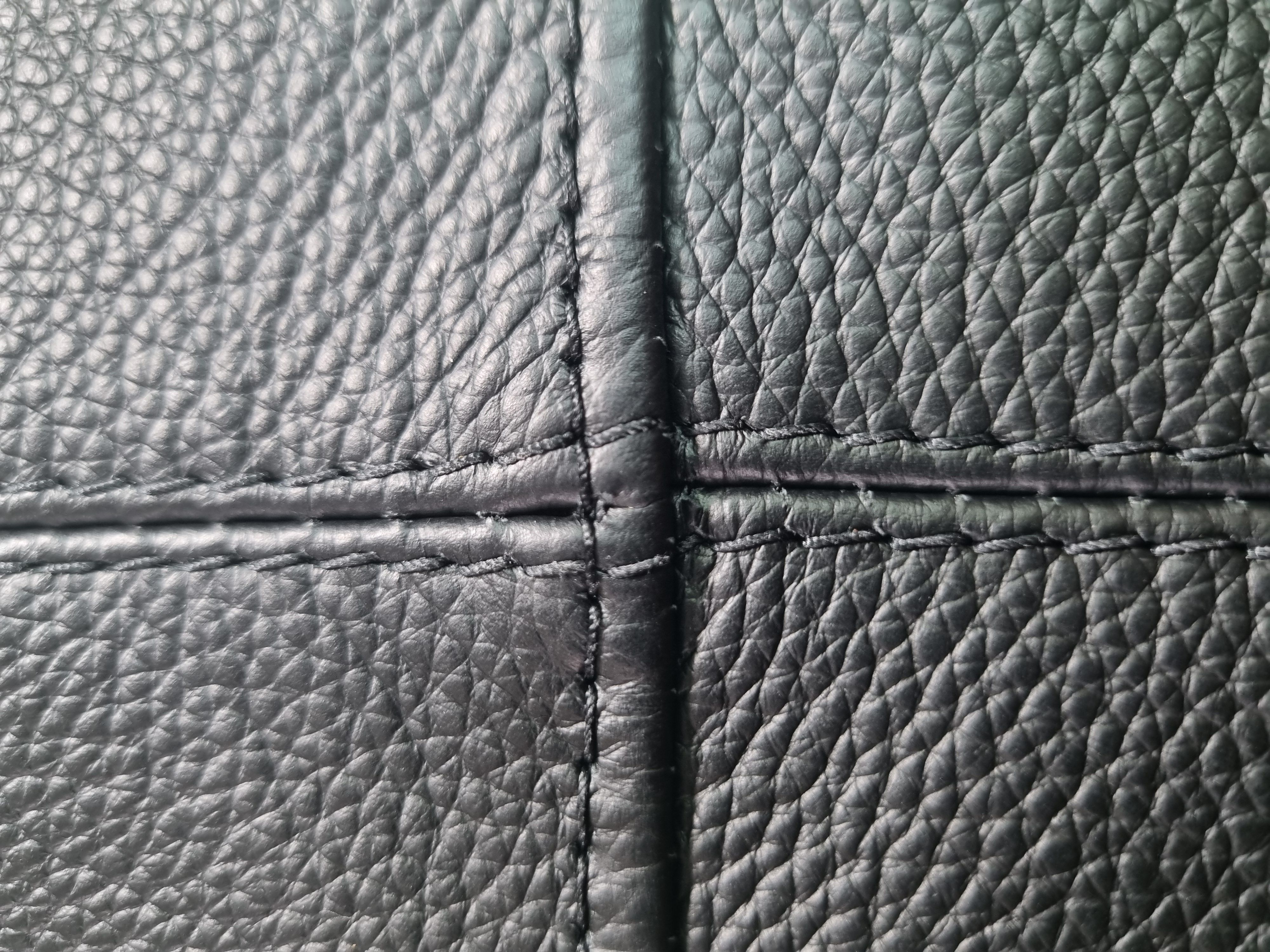

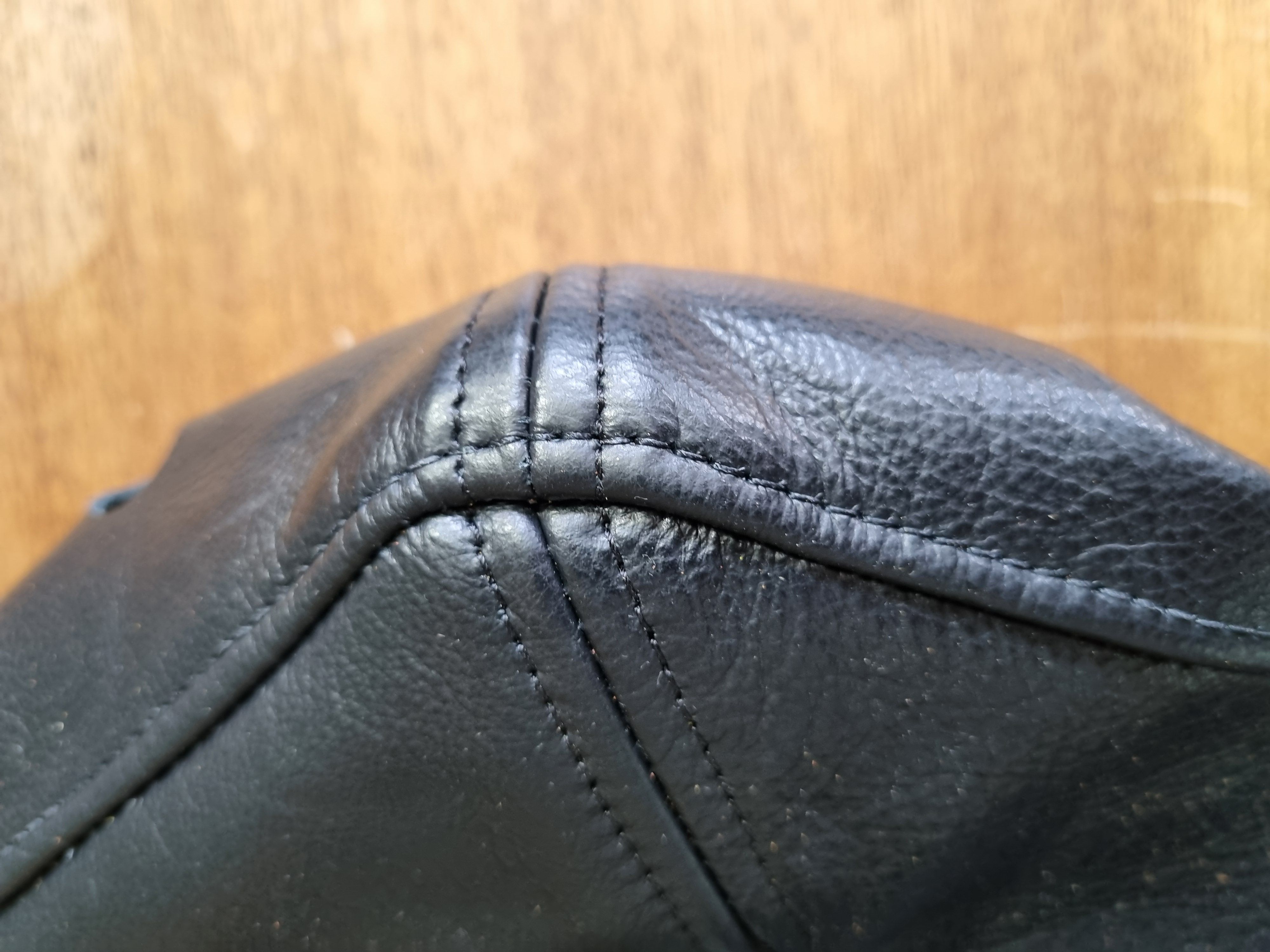

So next I'll have to attack the top part. I have 2 worries with the upper part... One is with the foam bolster that needs surgery but I'll tackle this later. The immediate worry is with the stitching. There is 2 French stitches that meet in the corner and will need a top stitching on top of that. That's a lot of folds... I'll trim the allowance but there's also a ruban underneath so the stitch dont rip open plus a 1/4" scrim. I practiced on thinner leather with the ruban but no scrim and I felt like my machine was maxed out... Thinking of smashing the area with a hammer. Any suggestions??

Looking at the photo, I believe the French seam was done before the 2 panels were sewn together to make the 3D corner.
John has a video where he was showing me how to do a similar feature on a shift boot/gator.

JimmieJoe wrote: Wed May 22, 2024 2:30 am Looking at the photo, I believe the French seam was done before the 2 panels were sewn together to make the 3D corner.
That's correct, this is my test run and I did both French seams and then joined the 2 together. It's the top stitching all around that I felt like my machine was maxed out... The leather I used is thinner than my upholstery leather and I didn't used scrim foam either on the test. So I'm a little uneasy about doing the real thing now...

#17567
Thanks for the foam repair video links, will watch later today. Regarding your seam, thaat is a lot of layers. Be careful that your stitch length doesn't change. I was practicing on various seams one time and as it got thicker, my machine struggled through it but ended up shortening the stitch. You mentioned Cechaflo, wish he would talk! All kidding aside, he had a video where he was sewing up multiple layers or something like that, he trimmed some material out to make things lay better - maybe that might help.

fibersport wrote: Wed May 22, 2024 11:11 am Thanks for the foam repair video links, will watch later today. Regarding your seam, thaat is a lot of layers. Be careful that your stitch length doesn't change. I was practicing on various seams one time and as it got thicker, my machine struggled through it but ended up shortening the stitch. You mentioned Cechaflo, wish he would talk! All kidding aside, he had a video where he was sewing up multiple layers or something like that, he trimmed some material out to make things lay better - maybe that might help.
Yeah, I think I'll have to do another test run with the actual materials so I know if it's doable or not. It's a focal point, I don't want to mess it up. I think I know all the technical stuff to do this but I also think that my machine reached its max. It's not a heavy duty shoe maker machine...

#17570
For that seam I would try and cut away as much of the foam in the seam allowance as possible and see if you can't get the results your after.

WILD BILL wrote: Wed May 22, 2024 10:52 pm For that seam I would try and cut away as much of the foam in the seam allowance as possible and see if you can't get the results your after.
I agree with you 100%.every little things will help. When I sewed the scrim, I was like a 1/16" off my seam allowance. I'll do that again. And where the French seams are folded, I removed everything that was folded in the allowance.

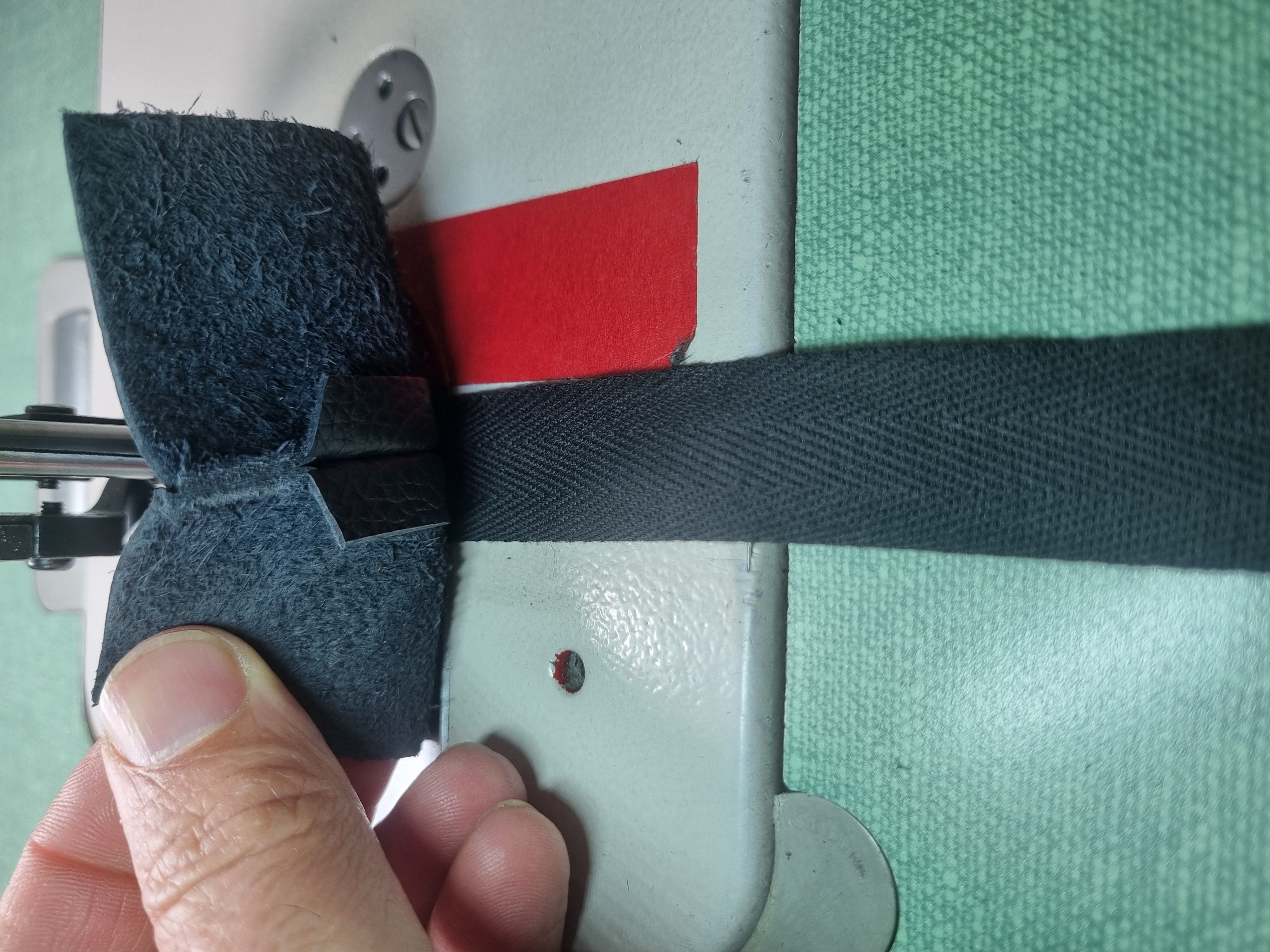

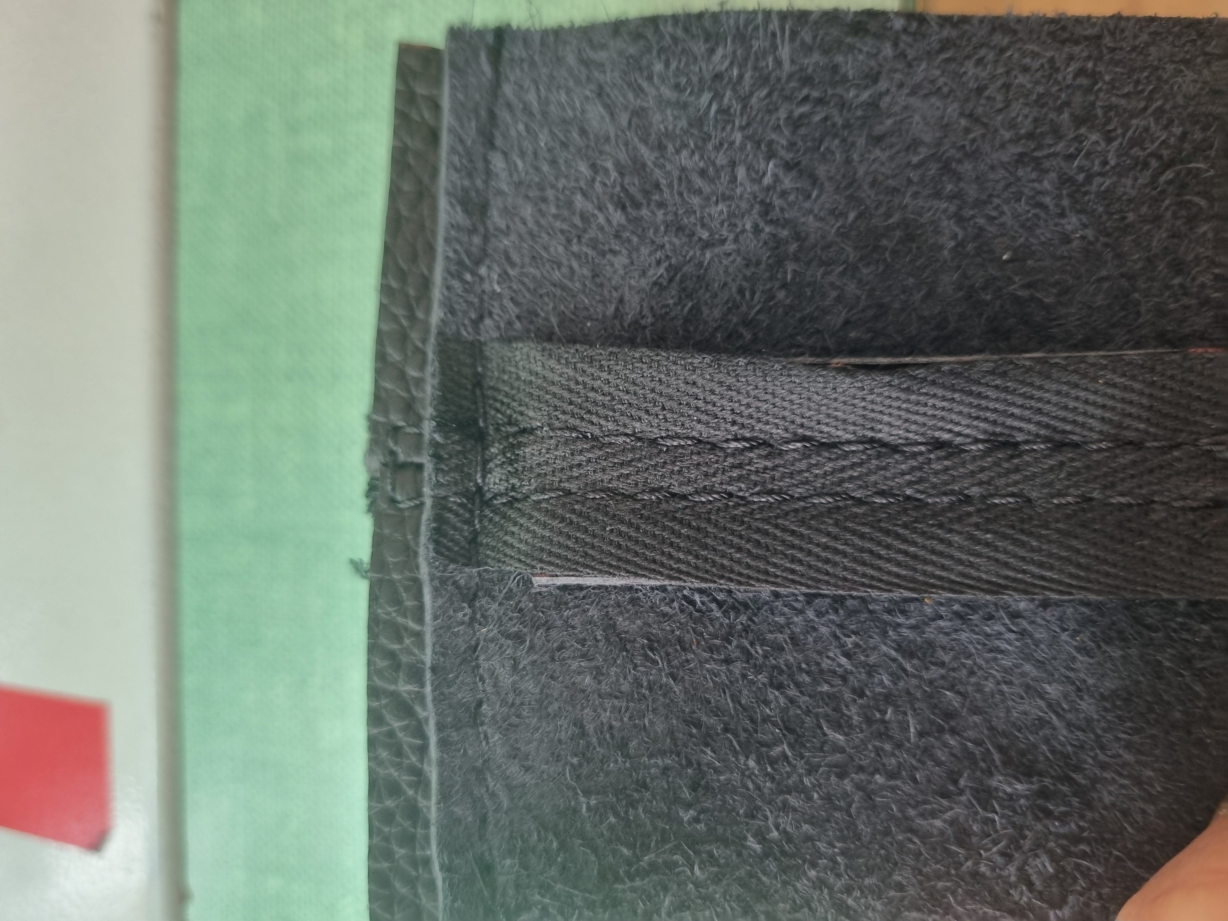

#17590
Alright I'll share what I've done to overcome that thick stitching in case one of you is interested. Please don't judge the quality of the stitching, these are quick tests... So first I upped from #22 needle to #23,it doesn't seem huge but the #23 is actually quite larger than the #22. I'm using Serabond 135 btw. When I'll do this for real I'll be gluing my leather seams and will also cut back the scrim in the seam allowance.
Basically, I trimmed the leather in the seam allowance leaving only 1/8". Then I top stitched the French seams with the ribben. After I sewed both French seams together, I narrowed one side by half. Then, I hammered the thick part where they meet and it took a lot of height down actually. The top went through like no problem at all.
Problem fixed, hopefully I get some time this weekend to work on the bolsters!
