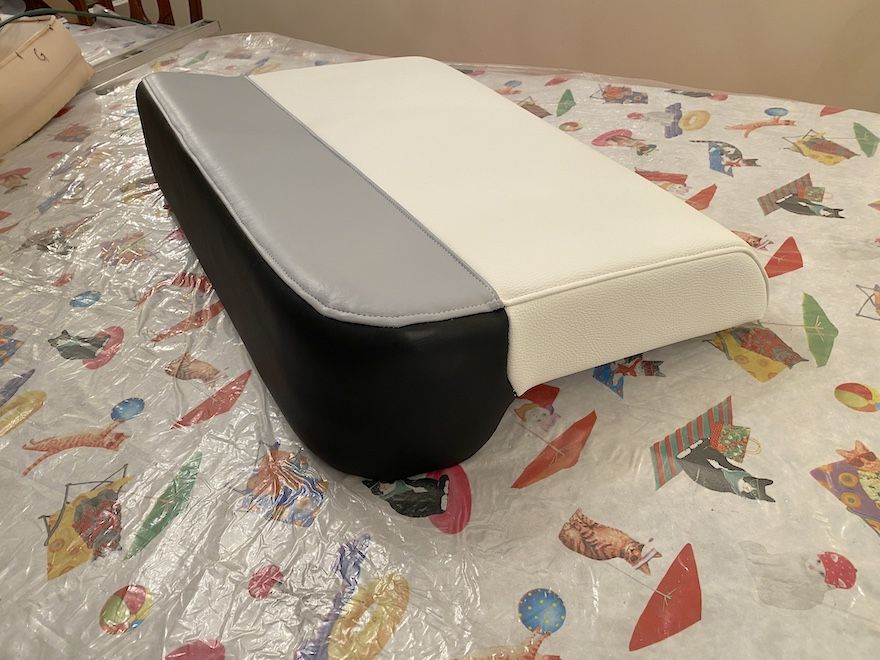

I goofed !!!
I hate it when this happens . . . :scream: :fearful:
IMG_2733 2.JPG (100.41 KiB) Viewed 14160 times
IMG_2732 2.JPG (106.73 KiB) Viewed 14160 times
The stitching at the curve was a bit 'iffy' to begin with and I was not able to compensate with the top-stitching (although I tried). It does not look too bad from a distance, but up close it is a sorry sight.
I'm still hit-or-miss on the curves. I think the 1/4" sew foam is making the sewing of curves and challenging areas all the more difficult. I may re-make this piece once I get to the end of the project.
The sew foam is making for a nice taut cover and gives the thread more to hang onto, but it is sure adding bulk to the fabric in places where it is not needed.
Thoughts?

Sucks when you are topstitching a finished piece and that happens, but its part of learning what works and what won't. Rounded insert corners like that are always difficult for me also. As soon as I think I've got it figured out I mess up the next one. I always trim back the sew foam in the seam allowance before I do the top stitch, this keeps the bulk to a minimum. Keep up the good work, learning from little mistakes makes you much better in the long run. Do you back the seams with anything to keep water from getting in? Or is it not really much of an issue? I've got a couple of motorcycle seats to do and am going to need to have sew foam under the material and was wondering how to keep them water resistant. I haven't done any boat work before, so I know nothing about it.

Thanks @Mikesimpson for your guidance. I do not provide any waterproofing to the seams for the boats I have done. Nor have I seen any boat manufacturers do such. The materials themselves are not prone to deterioration from water and many of the newer boats are made with the 'quick draining' urethane foam.
I suppose you could apply a bead of hot melt glue or other adhesive/sealant to the seam to get water resistance. Not sure how it would stand up to the test of time though . . .
As for the curves and the top-stiching, I am removing some of the foam from the corners where several pieces join. This has helped some, but I probably need to do more where curves are involved. Thanks for the tip! :thumbsup:

As luck would have it, I forgot to trim the foam on the most recent piece and then realized it as I was stitching. :tired_face:
I may re-make that piece once I feel that I'm gaining success and consistency.

I was able to re-make the panel that I messed up.
IMG_2737 2.JPG (142.6 KiB) Viewed 14115 times
The curve shape came out better and therefore I was able to get the top stitching to come out better. I figured if I could this this far, I'll make a new skin for the seat.

Here is the re-make of the cushion. . . All set. :grinning:
