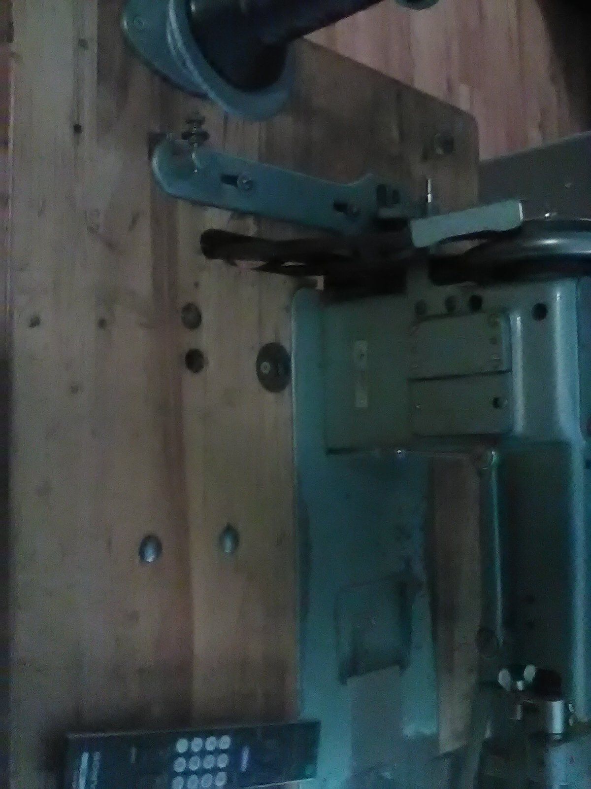

@Jayscanvas ,
A made in china machine with electronics. That's pretty cool to see, are you in your basement of your house? if so your getting your exercise hauling material down that's for sure!
By Jayscanvas
#2669
Yes it’s made in China but it’s a Korean company. Yes it my basement there is a outside entrance so I use a hand truck for the heavy stuff it’s not to bad.
