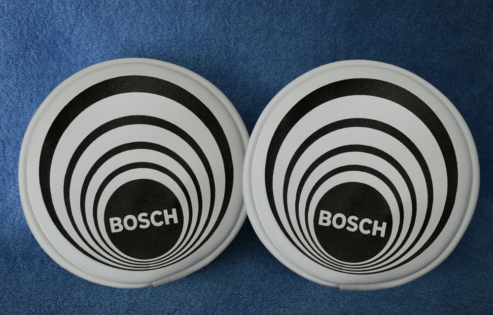

I am trying to make some rally lamp covers, like the ones in the picture.
Can anyone describe how that perfect circular seam is done ?
Bosch spotlamp.png (1.19 MiB) Viewed 4231 times
#4398
From what I can see its really no different than sewing any curved piece just the curve doesn't end. It takes a little practice to sew smooth curves like that. It helps to have good machine speed control or a servo motor.
