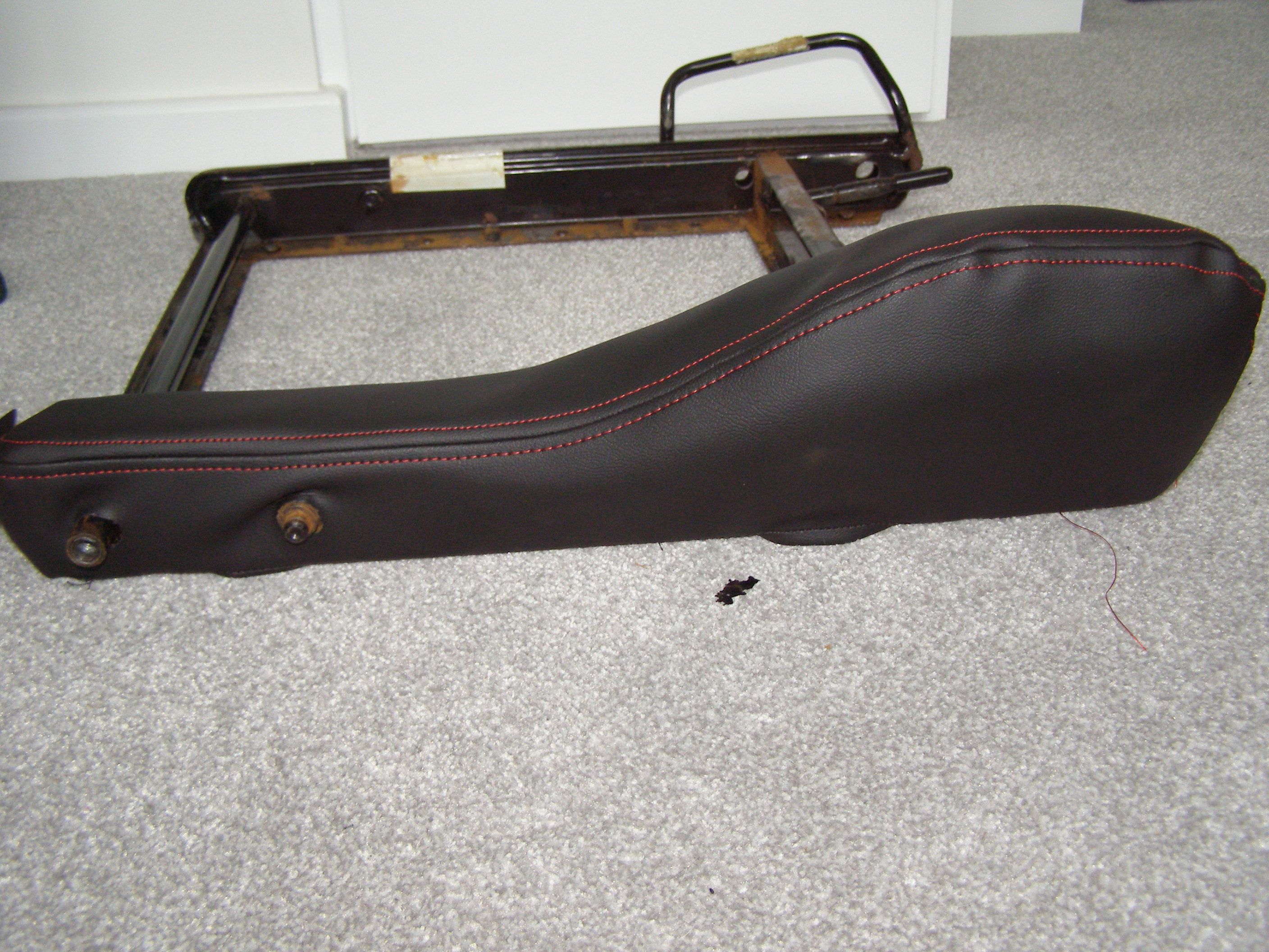

Here is a picture of my first attempt at a bolster, I know the top stitching is awful but that's due to the problems mentioned above, the machine runs too fast and is very difficult to control and get it to go in a straight line and the machine doesn't cope well with thick materials and can't pull them through easily. I also need to make a few adjustments to my pattern and to remove some material from the seam on the reverse side to follow the curves better, its my first attempt so it was bound to be less than good.

I too went with a Singer, I got the 4452 and found it to be less then adequate. I looked into the sailrite as well. and found that they were more than what I could afford. I then looked into some of the knock offs and wound up buying a REX 607. But I found that as it comes from Amazon it too ran way too fast for me to keep up with. So I took a portable machine and turned it into a table machine, removed the motor and installed this one https://www.sailrite.com/Sailrite-Workh ... Motor-110V and now I have total control. and any accessories that fit the sailrite also fit on the REX 607. Also the 607 is the same as the LS1, and the 607Z is the same as the LSZ1. The 607 and the 607Z They are way cheaper, but the sailrite itself is a better machine because it has been improved since it was first released. My plans are to use the REX till I know for sure if I am going to keep doing this and buy a better one at a later date. Possibly the Sailrite Fabricator. Or a nice Juki.
#3598
Discussed a lot here: Start up sewing machine
I would look for used before buyuing anything new. For example, in our area right now: https://stlouis.craigslist.org/for/d/br ... 58163.html
That machine or alike will get your issues solved. Speed reducing is another question but it's doable.
3 things:
1. Compound feed walking foot
2. Industrial
3. Servo motor (can be clutch too, you can upgrade for $100)
Trust me, it is not that easy to sew at beginning even if you have great machine. Using incorrect equipment is just shooting yourself into the leg. Making headrests with french seams like on picture above is hard(if not impossible) with table sewing machine, not even talking about non-industrial ones.
