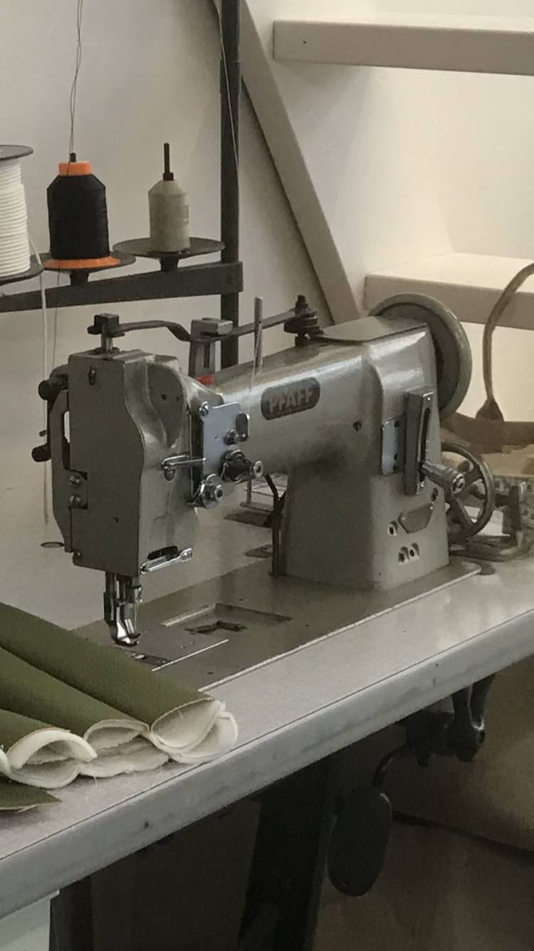

Hi Adam! Exaktly, I was sewing and raised the lever, and then it wouldn't come down. And from that moment, the lever on the backside's been all loose. I'm not sure exactly what a big leaf spring is, but I'll include a picture of the machine here in my reply, and maybe you'll be able to tell if that's the case or not!

That bar on top is the leaf spring i referenced, its for foot pressure rather than having a coil spring around the presser bar. Measure the height from needle plate to bottom of the foot, should be 11mm, if its more i bet its just in a bind. Reference @John's diagram and try tapping it down.
