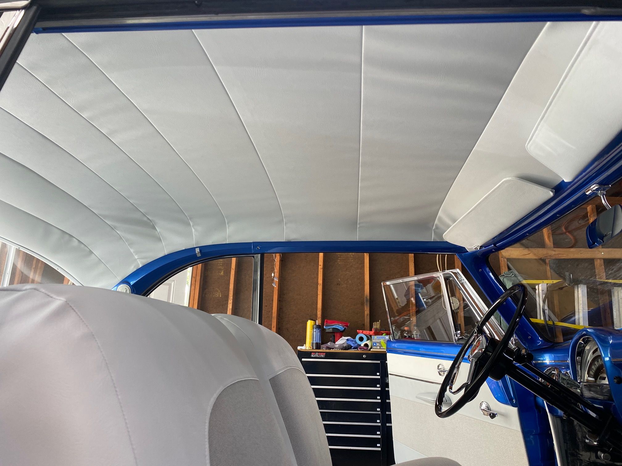

By 53 Vick
#15206
Ken,
I'm glad that you found this forum and the post offered some inspiration for you. It definitely helped me out a lot being a first timer. I was reviewing my posts and realized that I never posted a picture after I finished. Those with a sharp eye will notice that I still don't have the kick panels done. I'll get to them eventually.
I made my own headliner and it was probably the most time consuming and challenging piece of the whole interior for me. It isn't perfect by any means and there are some wrinkles in the corners, but overall I'm pretty happy with it being my first one. I'm not sure I'm the best person to ask questions about how to install a headliner because I'm sure there are other and maybe better ways than what I did.
The front and the sides had tack strips that I stapled the material to. I think I started along the sides and in the middle and you just gently pull, stretch and staple. I worked from side to side from the middle up to the front and rear. The front corners gave me some difficulty and that's where some of the wrinkles are. Knowing what I do now, I might have cut a relief and sewn it together for an angled seam into the corner. Not sure if that would be the right way to do it or not but just what I was thinking of now. I'm sure pros have other tips and tricks to do it the right way.
The rear was challenging as well. I spent a lot of time looking at the old headliner as a template and installing the bows and making new templates and I still didn't get the pieces just right. There are a few wrinkles in the back corners as well. As far as fastening the rear portion, I believe that the shop manual tells you to have the rear glass removed. I already had the glass installed because I didn't realize that this was the process and I wasn't going to remove and install again. I attached the headliner to the 100 or so little "hooks" stamped along the edge of the window and eventually covered by the trim. And I'm pretty sure I used glue while stapling and hooking everything in place.
Again, I'm no pro and just did what made sense to me at the time. I'm sure there are better ways to do everything I did but that's how we learn, through trial and error.
